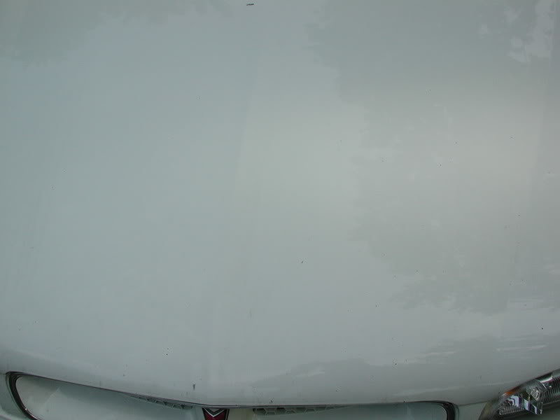

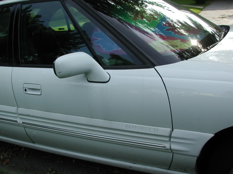

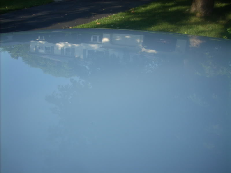

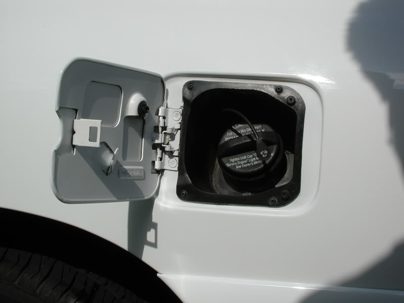

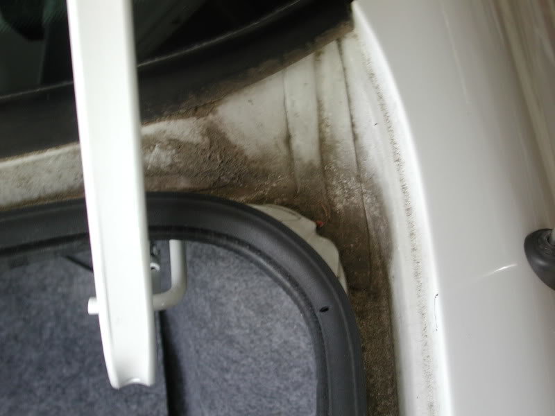

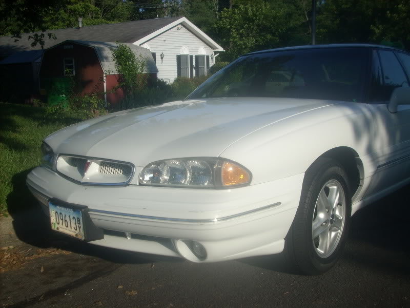

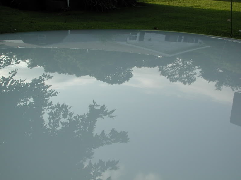

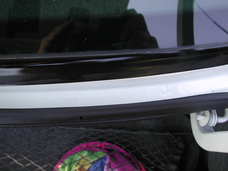

    This may be a little more than you wanted.
    Detailed my Sister’s 98 Bonneville
    About a month ago I offered to troubleshoot a keyless entry problem on my sister’s car. When I opened the hood to check a fuse in the fuse center I was real sorry that I did not have any gloves with me. Right then I offered to detail her car. This past week my sister has been at the ocean and I had the car from last Thursday till tomorrow. She will be amazed when I return the car.

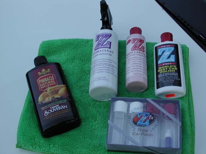

    My basic process was as follows.
    Wash car with Z7
    Claybar with leftover Pinnacle Poly, Megs smooth surface, and Z18 clay.
    Use Makita with FMP and SIP for major scratches
    Use Makita with FMP and Micro for swirl marks on paint.
    Use PC7424 white pad and Micro on the plastic body cladding.
    Use PC7424 with blue pad and PO85RD for final polish
    Do an IPA wipe down
    1 coat of Z5P
    Z6 wipe down
    1 coat of Z2P
    2 coats of Pinnacle Liquid Souveran wax

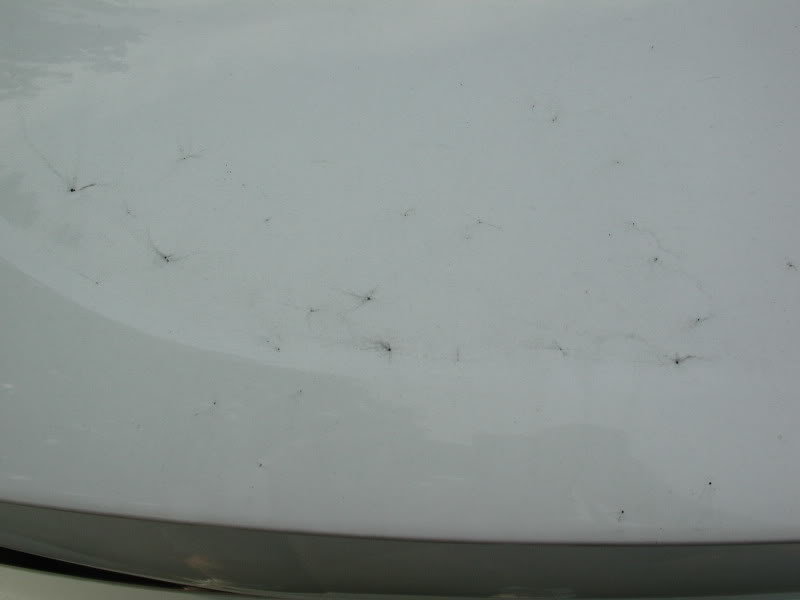

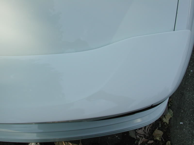

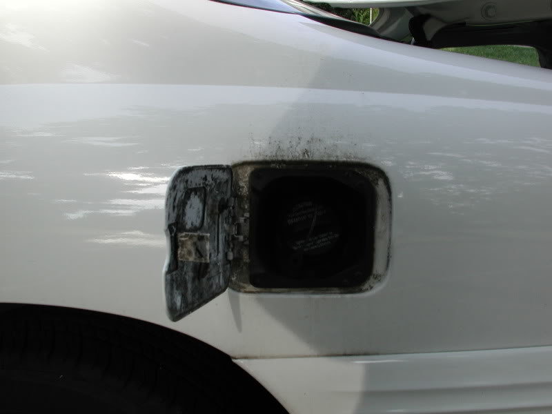

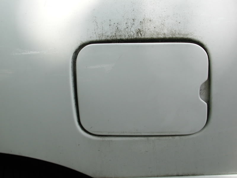

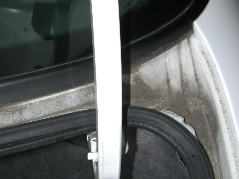

    Here are some before pics.
    Just Nasty.
    Then we polish, seal and wax.

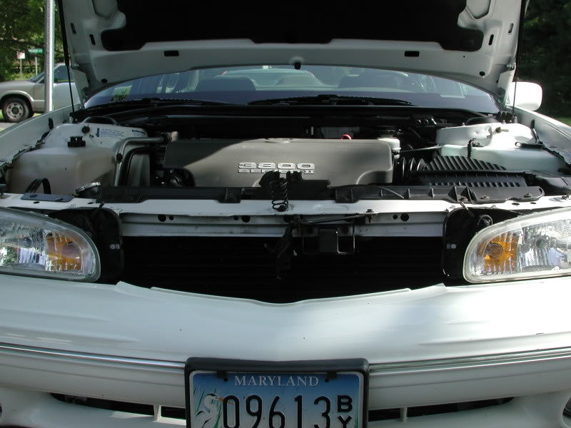

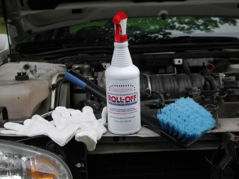

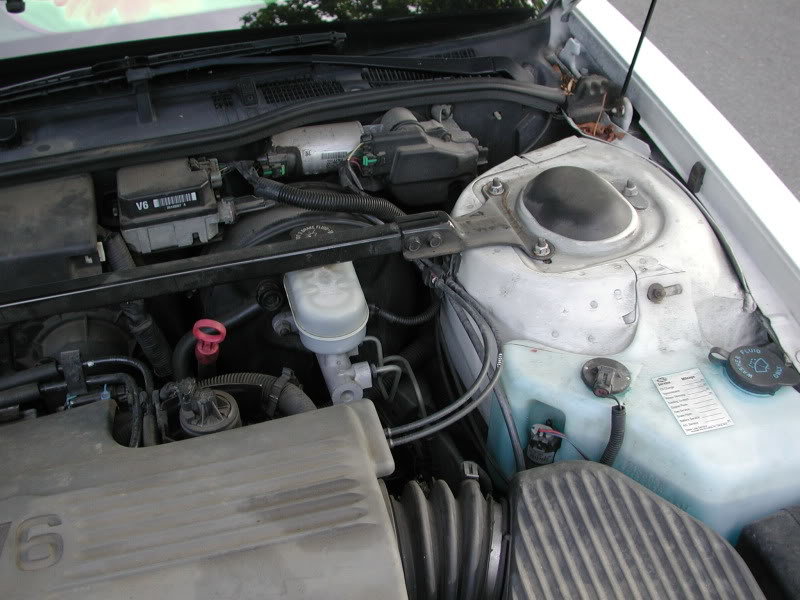

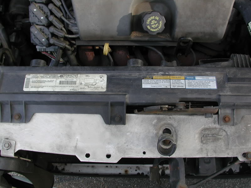

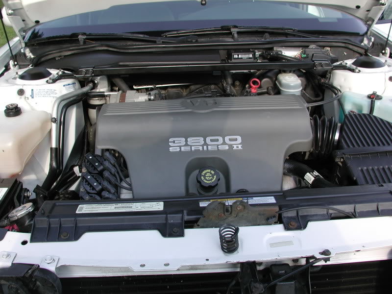

    Engine Bay was filthy.

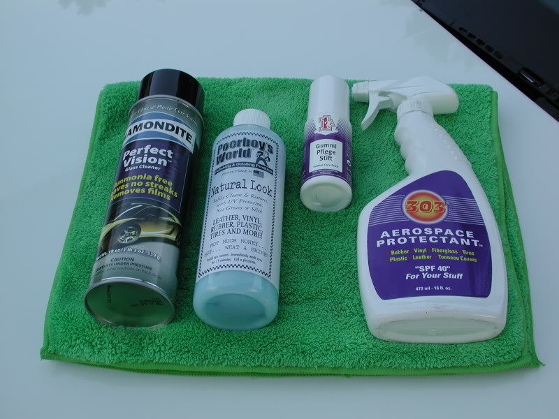

    ARO, Microfiber gloves and a brush took care of the filth. 303 added some protection to the rubber and vinyl items and Gummi Pflege helped with the seals. Diamondite window cleaner helped with the windows. Poor Boys cleaned the inside plastic and Folex cleaned the carpet and cloth seats
    Opps all better now.

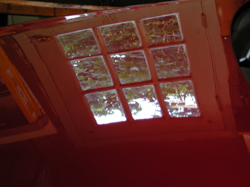

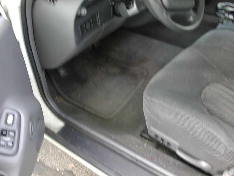

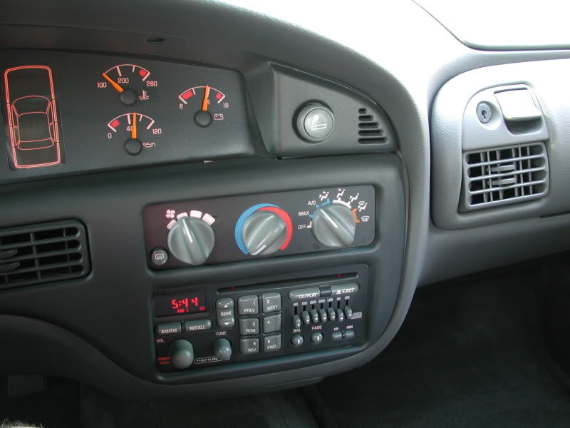

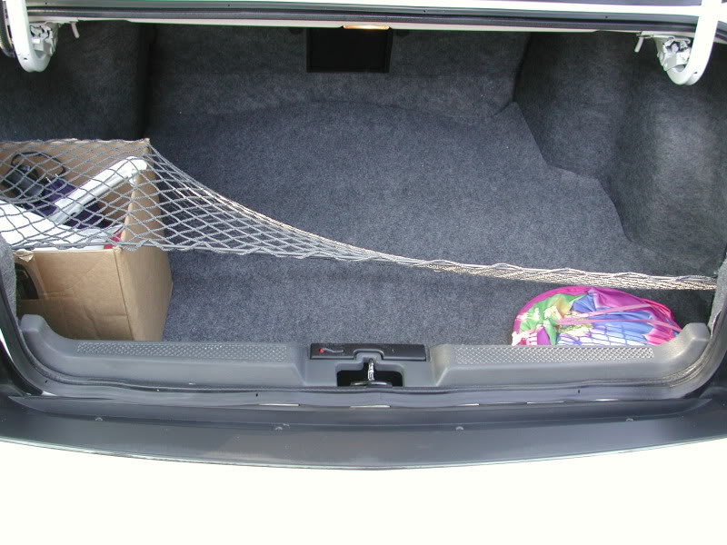

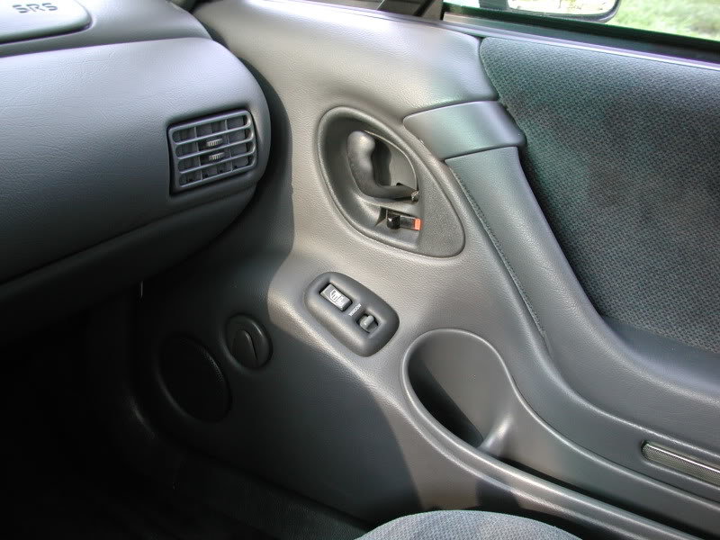

    Now for a few interior shots.
    Only one before shot but the entire interior was in this shape which was not too bad.

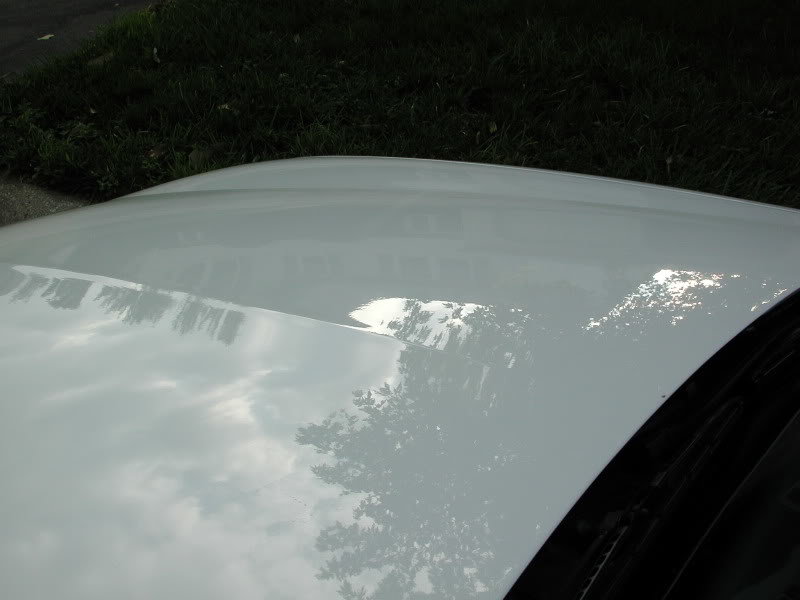

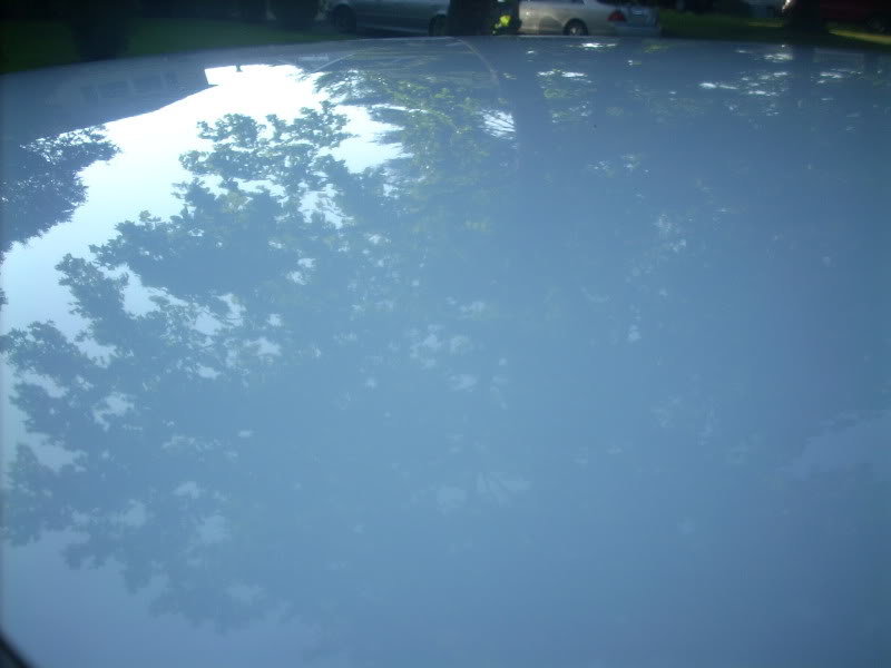

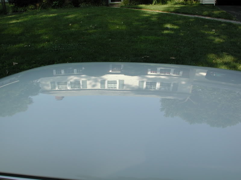

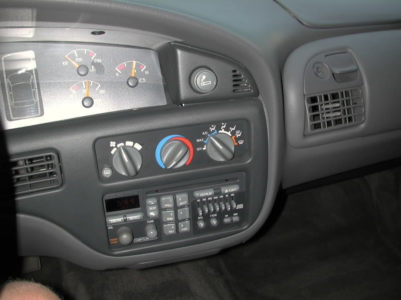

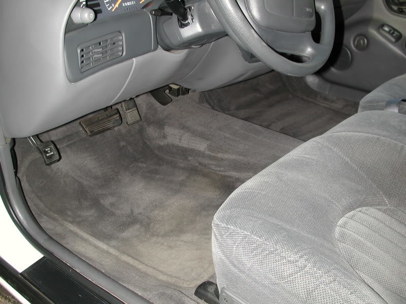

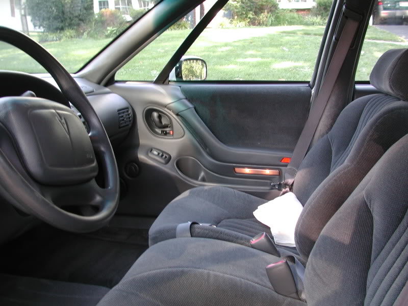

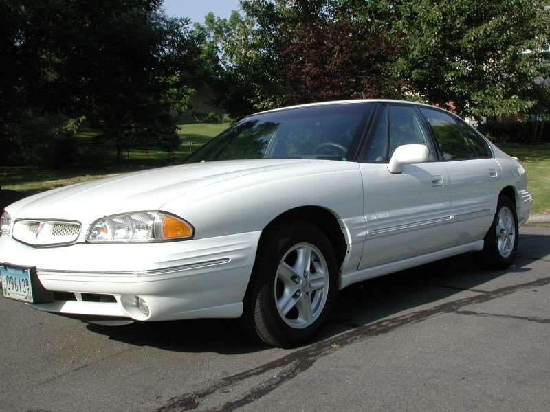

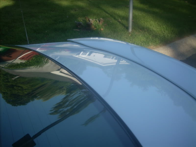

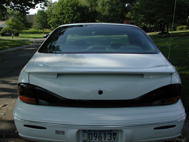

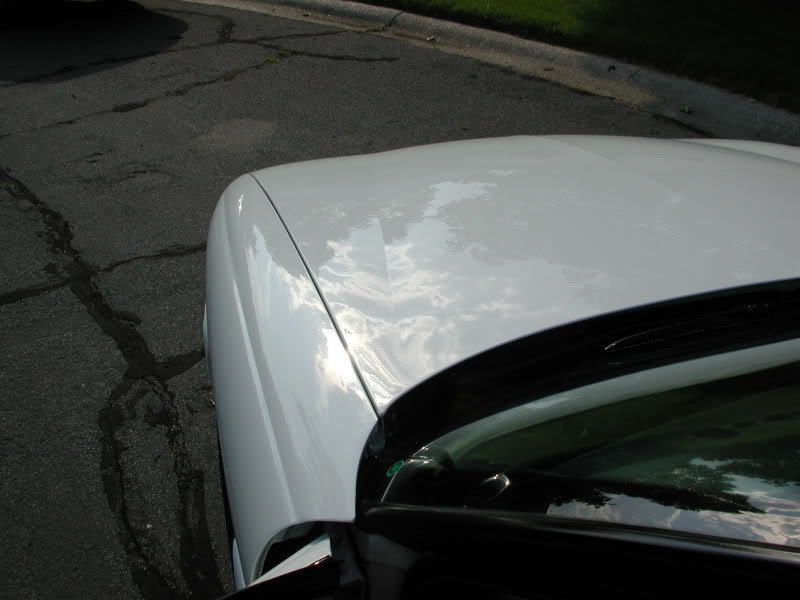

    The After shots
    I have to say that I really like the way Pinnacle Liquid Souveran wax looks on white. The wax goes on smooth and wipes off easy. It is like using liquid butter.

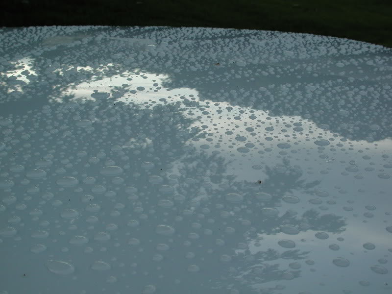

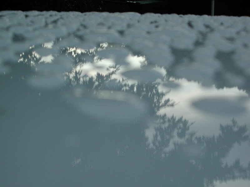

    It rained last night so I took a few morning bubble pics because I know you guys love them.

    That looks like an outstanding and epic job. Must feel great to have transformed it. How did your sister react?

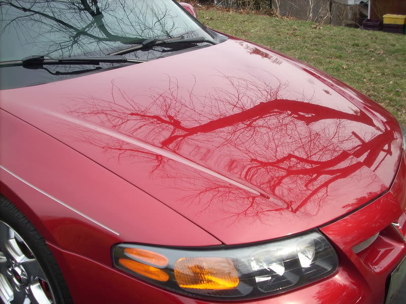

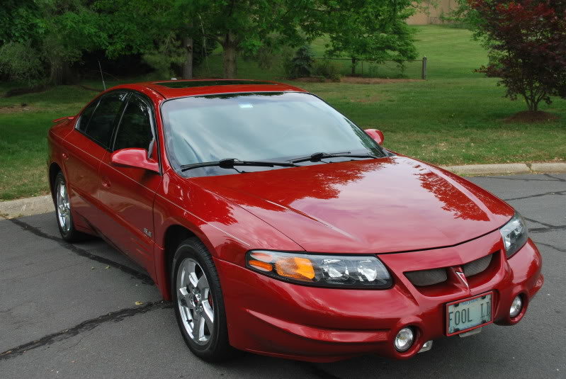

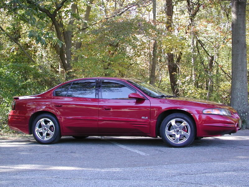

    This is my Bonneville.
    My favorite Pic.
    She thought it was a new car. LOL

    Wow :eek: that car was FILTHY!! I could never let my truck get like that, it makes me anxious when it has rain spots on it....like it does right now lol.
    Great job, it does look like a different car. :cool:

    For the engine I like Amazing Roll Off because it works for me. I also like to use a microfiber glove to do the engine. Just be sure to put a thicker latex glove on first, to protect your hand from the chemicals, and put the microfiber glove over top of the latex. Your fingers can get in all the recessed areas. I also have a few dedicated brushes I use on the engine as well.
    Once cleaned 303 Aerospace Protectant can protect and dress up the rubber and vinyl items under the hood. I also use a sealant on the painted surfaces under the hood. Makes the next clean up a breeze.
