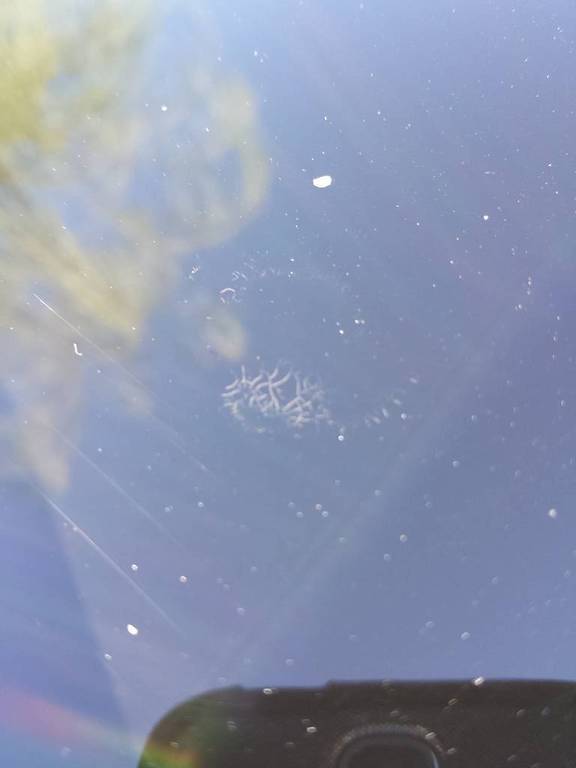

    I'm not sure what caused this or what it is but how do i fix it? I have 4 of these on my hood and they are all in the same corner and the biggest is about the size of a penny. Any idea what its from and how to fix it? Any help is appreciated.

    That is pretty strange. Almost looks like a crack in the clear coat or a very peculiar water spot. I would try to remove it with a claybar first.

    okay i will give it a try next weekend. i originally saw it a few months ago but there was only one of them. now there are multiple and i have tried washing them and buffing them out but haven't had any success. hopefully the clay bar will work.

    Did some research and either its a problem from the factory with the clear coat or the sun/heat did it. Its only a year and a half old with 20k miles so I find it hard to believe this can happen that fast especially because I do put on a good coat of sealant every 3-5 months and was it almost weekly. I will still try the clay bar but any other ideas what I can do? Is it worth taking it into the dealer to complain about the clear coat issues?
    http://www.detailingspot.com/?page_id=224
    I can assure you I don't let bird crap sit on my car so possibly the previous owner did.

    The clear coat crack, in the link resource, did talk about trying to use a glaze to fill and hide the problem. Be aware that you will need to reapply the glaze after you wash the vehicle. Glazes typically are removed by washing the vehicle.
    Since you indicated that you already polished I do not believe a clay bar will help but you never can tell.

    I fully detailed my car yesterday and the crows feet are still in the paint. Guess there isn't much i can do. I'm going to try and complain to the dealer and say its a faulty paint job and hope they will fix it. 1 in a million chance it will work but might as well give it a shot.

    Have you tried a heavy buffing compound to remove that spot?

    I had the same happen to my 12. The dealer is repainting the hood as it was a problem with the prep job from factory. Give it a shot.

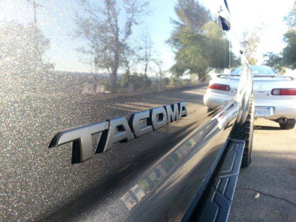

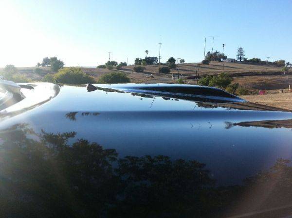

    washed and waxed today:
    [​IMG][​IMG]
