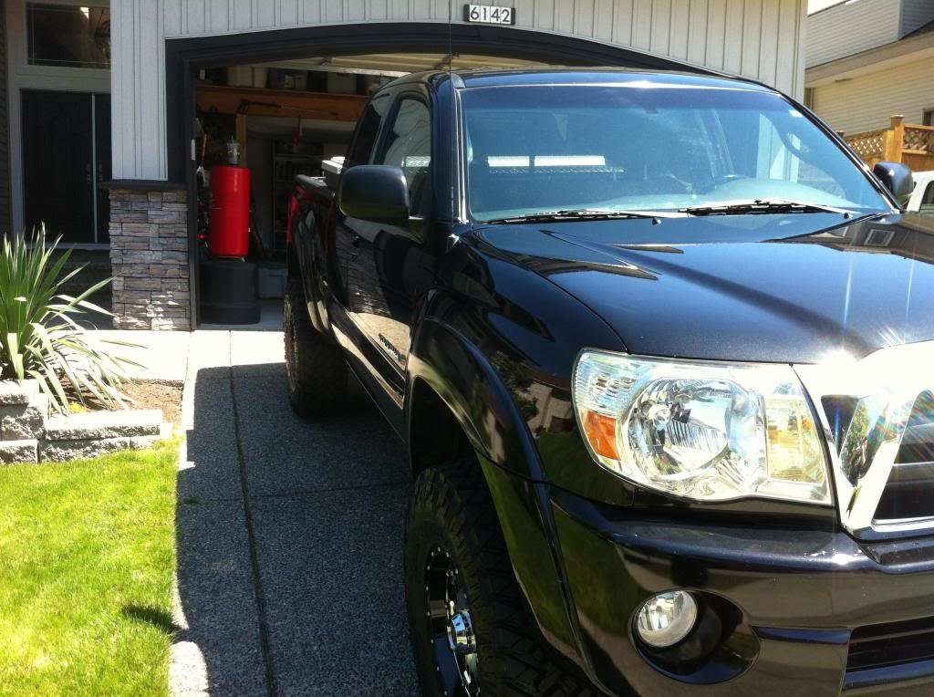

    http://www.homedepot.com/p/Makita-7-in-Sander-Polisher-9227C/100594840
    I love this polisher. It is tough as balls we used it at the shop I worked at for over 2 years and then I got it when they got a new one that wasn't beat up.
    Then I would grab some 3m polishes/pads from here. http://3mcollision.com/products/buffing-and-polishing
    I really like this stuff because it is pretty simple to use and gives you a lot of variety in what you can do. Colour matched pads means it's simple to keep track of what your using too.
    For trail rash I would use the white cut polish then the blue swirl remover to flatten out the scratches. I've done the same thing on my truck and my dads black ram and it worked great. I bet you could get away with just the swirl remover even because it's a white truck. :cool:
    It's a bit of cash but it will last forever so I think it's worth it.
    Bad Iphone 3 picture but eh

    Yes the Makita 9227c is a nice rotary however all direct drive rotary polishers are not as user friendly as a DA machine. You will remove defects in a hurry but it takes practice to be able to finish hologram free.

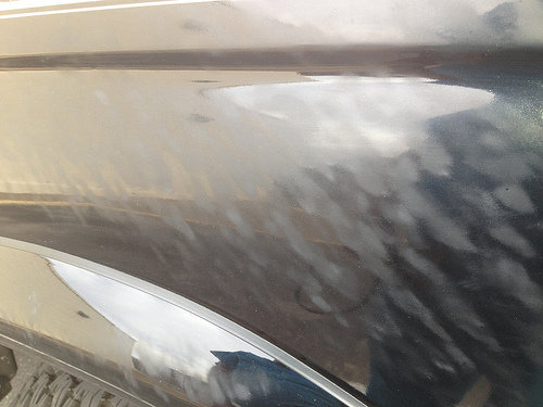

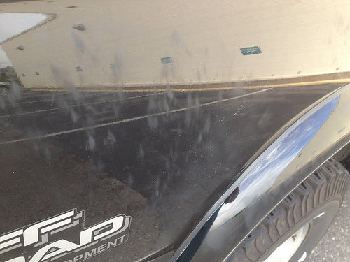

    I was recently moving, and because it was raining, I used a tarp. Bad move. It did this to my paint afterwards. I'm not sure if it's under the clear coat or not. What would you recommend? A polish? ScratchX?

    That is really minor. Grab some off the shelf polishing compound and a fine polish to finish. Should be no issue at all, even by hand.

    I DL'ed the pics, and processed. All of that is scuffing on the clear. No tarp is going to get into the clear. Just my opinion.
