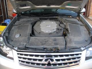

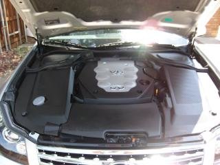

    I use plastic bags and cover the alternator and any electrical components, as well as the air filter. It depends on the vehicle. All of the new vehicles have so many plastic parts you normally don't have to be terribly concerned. For the Tacoma, I just cover the fuse box and use a pressure washer and avoid any of the other areas of concern.
    I use an all purpose cleaner for cleaning up the grime if it needs it. I have used simple green in the past, but always felt like I was really having to clean for it to fight hard stains.
    Below is a vehicle I detailed this weekend. The after photos was before I dried the engine compartment and added the VRT dressing. I used Adams all purpose cleaner diluted 2:1 due to the grime and worked great.
    Before:
    After:
