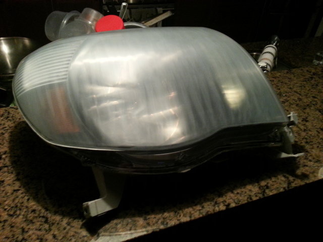

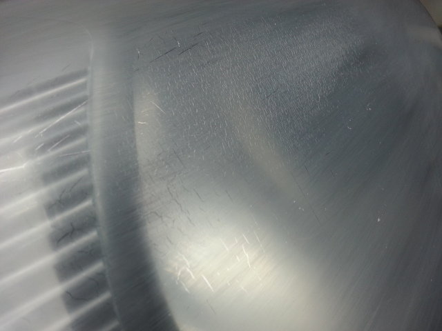

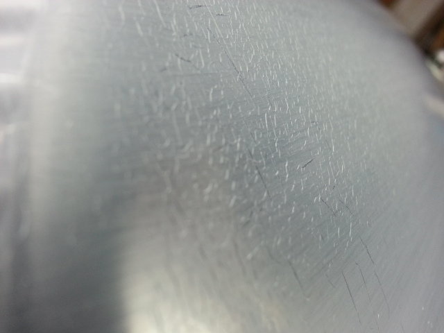

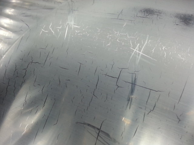

    Hi guys! I've been trying to restore one of my pitted headlight lenses lately and it's getting progressively worse!!! I'll cut right to the chase and show you the pictures in what has been a series of unfortunate events...
    2000 Grit wet sand before acrylic clear coat.
    The clear coat turned out great! But then I noticed these "cracks" in one spot... I thought I must've gone too heavy on the first coat so I sanded it all down again only to find that they're in the plastic??? :mad:
    I continued sanding vigorously, and eventually they began to fade to an acceptable level. Before spraying again I tried out an automotive degreaser this time, rather than the rubbing alcohol I had used before. This f**ked things up real good from the looks of it! Little cracks everywhere like a dried out desert! :confused:
    At some point or another I tried the buffing strategy instead of the clear coat but apparently I'm not very good at buffing. What should my next move be before I COMPLETELY ruin it? :eek:

    Get one of those cheap kits from Harbor Freight or your local parts store and use a drill with the polishing pad and the polish they provide. I'd just polish the crap out of it until the results are acceptable. Worst case, you have to buy new headlights, but it looks like you're already in that boat now. May be able to salvage them with the polishing kit.

    I happen to have one of those kits with the drill attachment that you speak of. I'll try buffing the bejesus out of it after work and report back. Thanks!

    2000 grit is nowhere near fine enough to finish with on that. may be why you keep getting the haze. go back with the 2000 if you get a chance then do a wet sand with 3500 and then do a polish. should speed up the process and offer a nice result. did that to my wifes previous vehicle before we sold it. worked well for me.
