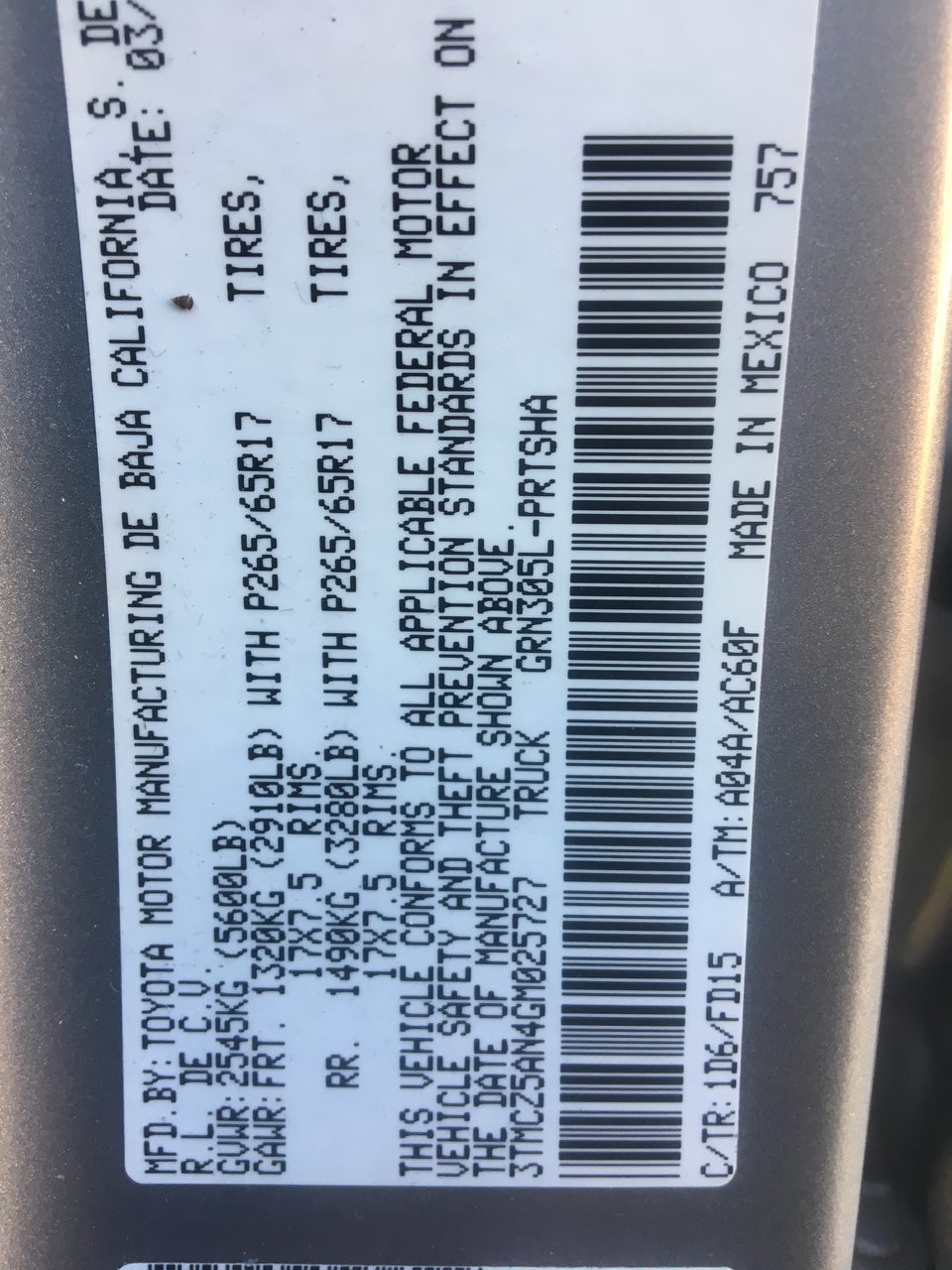

    That Diff code stuff should be on your door VIN plate, not the sticker on the diff, also I'm quite sure its no longer possible to get a factory 4.56.

    Yeah
    ECGS said the 2016 year changed gears and axel spline half way through production year (which explains why they didn't have an answer)
    Door sticker didn't say anything about gears or at least my crayon eating brain didn't see any

    it should be in the bottom RH corner by the trans code.

    I guess its in the middle on third gens: your diff code is A04A, which should be the factory 4.30 ratio
    Trans code is right next to it (AC60F)
    That said, doing a rolling check (if possible) would be best.
    And unless I misunderstand the condition of this diff, you might not "need" gears, you might just need to do a rebuild with a solid spacer and eliminate the auto-engaging clutch thingy...
