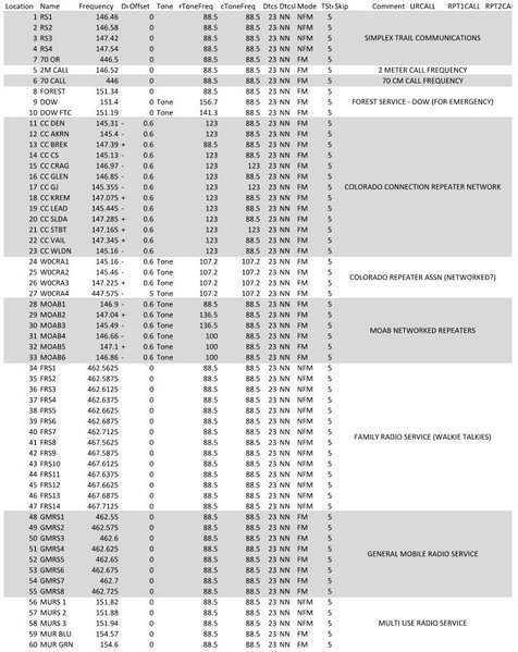

    Also, be careful with that list @chenbro . There are PD and FD frequencies on there. On MY radio they're set so I can't transmit on them, but depending on how you set up yours, you might be able to. I probably shouldn't have put that out there.

    So here is a link to a folder with our 1st draft, semi official TacomaWorld Colorado Chapter Ham List :D
    https://drive.google.com/open?id=0B0nBiqObudNyQjFFZ3RxdWFucjg
    I'm sure this will get modified over time, but at least it's a place to start. If we all run this list, it'll be easy to just say "We're on channel 23" or whatever.
    As stated previously, use the CSV to import into your stock config (after saving it first)
    You have information "Alpha"

    If you set your radios in chirp there is an option to set chA to freq# and chB to freqname or vice versa

    I was thinking about doing that Andy so I could tune both to the same channel and see the frequency.
    I might just print out my channel list too though.

    @aero3685 once someone confirms the link to my Google Drive folder works, maybe you could put it in the op.

    Worked for me.

    I like having mine that way. It makes it easy to share with someone who doesn't have our local file
