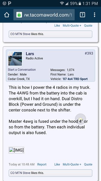

    This is how I power the 4 radios in my truck. The 4AWG from the battery into the cab is overkill, but I had it on hand. Dual Distro Block (Power and Ground) is under the center console next to the shifter.
    Master 4awg is fused under the hood 4" or so from the battery. Then each individual output is also fused.

    The picture worked for me. I can see it just fine.

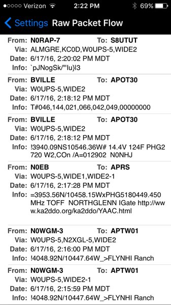

    It's been a while since I've read a circuit diagram but I was able to build a phone-to-uv5r cable and send/receive APRS packets today.
