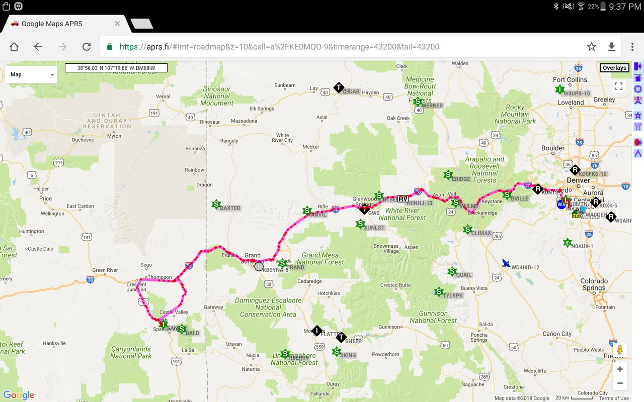

    Here's how the APRS coverage was for me on my short trip to Moab this weekend. This was using medium power on my radio (10w) and a Comet 27" antenna on a hood hinge mount. I expected the coverage to be good on I-70 which turned out to be true, but the coverage on the smaller highways to/from Moab was good too. Even in some deep, narrow canyons. As you can see from the map my beacons were getting picked up by digipeters and i-gates many many miles off my path.

    APRS is a quasi-mesh. So if there's a digipeater it will listen to packets like any other radio. If it's just two radios, no I-gates or digipeaters, they'll just pass packets between themselves. All the radios within RF range will hear your packet but not all of them do anything with the data.
    Any digipeaters are sniffing on the packets to decide what to do, whether to just repeat them, send them to the Internet, etc. That's what the WIDEn-n telling it, how to relay the packet. They operate on a store-and-forward concept, meaning they hear a packet, decode it, wait for the channel to be clear and re-transmit on the same frequency.
    That's how the whole system can work with individual stations and repeaters on the same frequency. Watch when you transmit a packet, a couple of second later the digipeater will send your packet and that's when it shows up as a heard station on your list.

    Have you tried a different antenna? You should be able to hit a dozen or more repeaters in Denver with your radio.

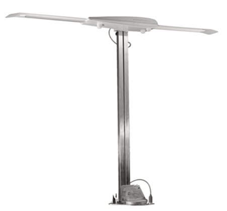

    I have question for the knowledgeable HAMs out there (obviously I am not:smack:)
    I'm looking to add a Yagi Wi-Fi repeater antenna to travel trailer. My bright idea was to mount the yagi to the TV antenna that we never use. This would allow the antenna to raise lower and have 360 degrees rotation which would be great for a directional antenna. Added bonus is there is already coax running to the TV antenna so I won't have to run anymore cable.
    Here is the TV antenna mast thats already on the trailer.
    This is the Wi-Fi repeater antenna I'm looking at.
    I was going to mount the yagi to one of the fins of the TV antenna with square u-bolts.
    My question is will I need to cut off the fins of the TV antenna to prevent interference or am I over thinking it?
    Thanks!

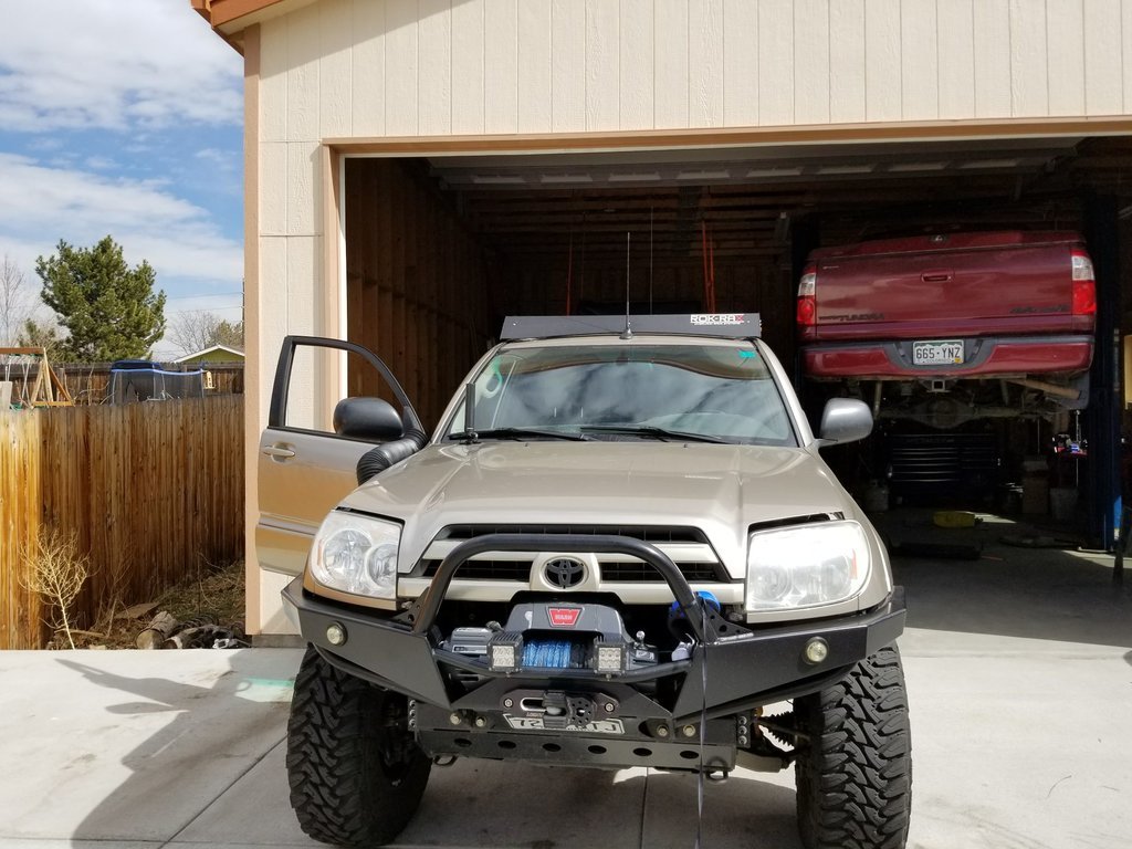

    Working on my antenna placement for upcoming radio changes. The "wide band" 2m/70cm antenna on a hood lip mount. This antenna claims gains in the indirect line of sight communications, COMPACtenna. I mounted it on a Diamond K400SNMO mount to the back of the hood. The Devils Radio (CB) is a President "New York" antenna, it is a mag mount and will be center mounted on the roof in front of the rack. I need to finish up that Tundra job so I can get my runner in the garage.
    Antenna site with videos
    https://compactenna.com/
