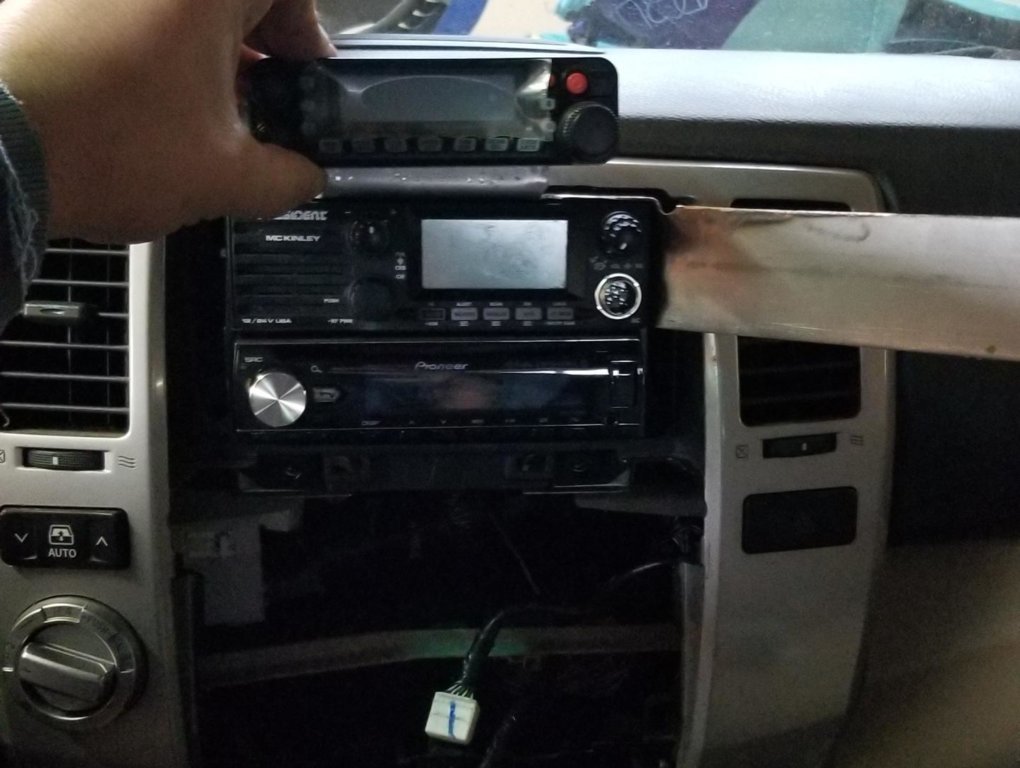

    Building out my mounts for my ft7900r and Android GPS/APRS phone. Might upgrade to a small tablet.

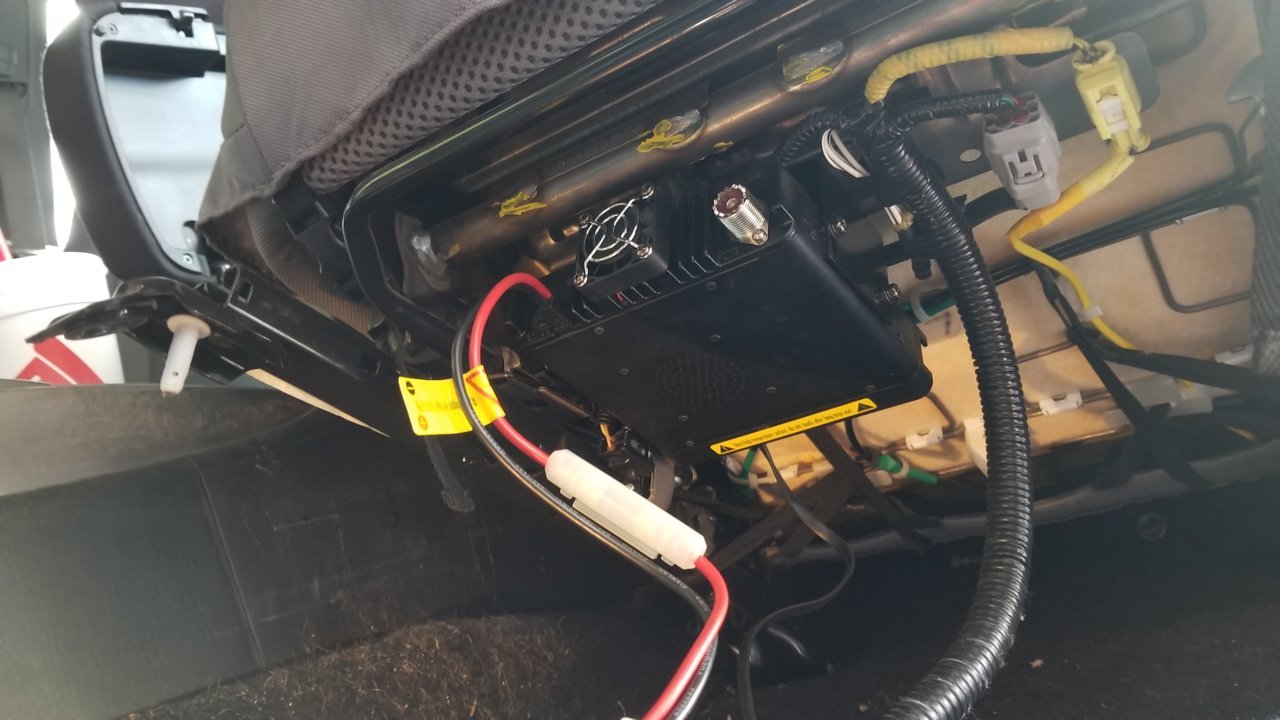

    That said, my speaker has a volume control and I like that accessible. It's also pretty easy for me to plug in the cable to program my radio while it's mounted under the driver seat. Not sure what the echolink plugs look like though.

    This obviously is with the seat tilted back but the cables are all in the front there and easy to connect with the seat bolted up. Power and speaker wires are now tucked in to the side of the console. Kind of nice way to run them, no need to drill or even disassemble anything.
