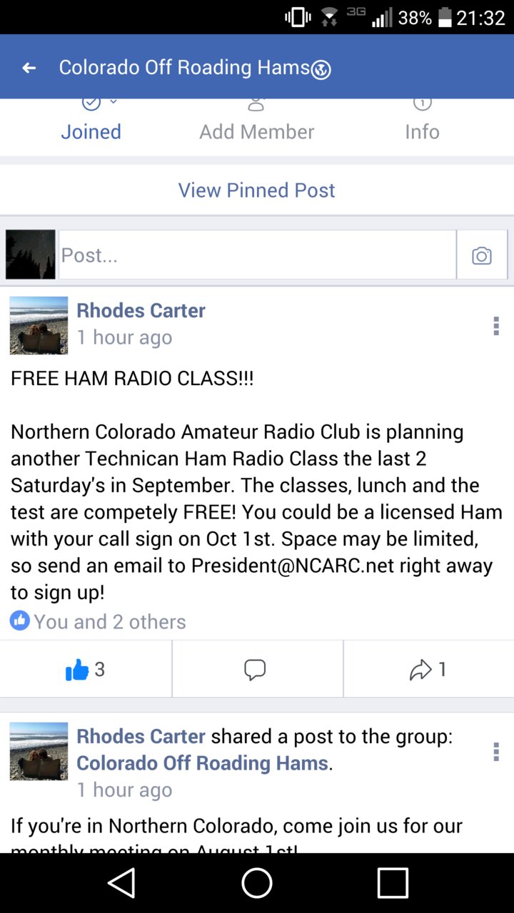

    Saw it on the face machine... Free class in North co
