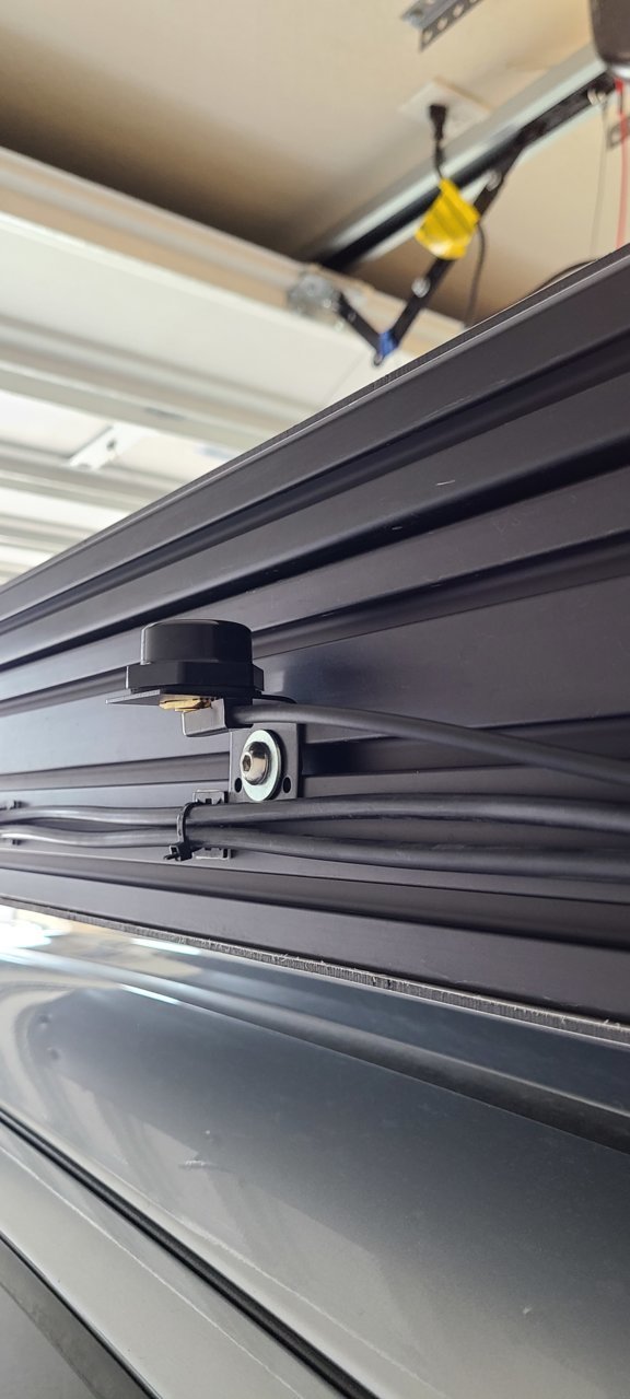

    bringing this back to life since its time to upgrade and redo my antenna was using a simple mag mount on the roof, but now have a Camper taking up most of the roof. i seen some NMO mounts on the hood and front bumper wondering what other options I have, running a yaesu FTM-400. @bot102 what where you planning to do on yours?

    @thefatkid had an antenna he liked mounted on hood lip by windshield. Think Eric (Gramps) was running the same set-up.

    That’s the antenna that @Littles is using?
    I feel like he’s had more radio issues Thant the mad or roof mounts.

    I do believe I have the same setup. I can always hear you guys fine, but you've said in the past my transmit quality is not so good. Originally the bracket was not grounded, but have since ground down the paint on the back lip of the hood where it clamps and I think it has since gotten better? I can't hear myself, so you'd know better than I would. Was it any better at eagle rock compared to last year?

    Did the NMO mount with an L bracket, can buy the whole kit on Amazon for like $40

    I'm running this setup on my 4runner with no transmission/reception issues. I'm on the right corner of the hood. I didn't use the paint protection pad so my allen/grub screws pierced the paint. I sealed the area with a dielectric spray. I will be moving to the roof/roof rack here soon when I eliminate the CB, it hasn't been on in over a year. Will get a dedicated FRS/GMRS radio as it seems that is where the unlicensed communications are shifting to.
