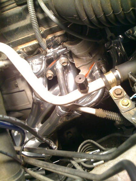

    Just got mine installed on my 2.7l:
    It wasn't too bad of an install, took a few hours, everything bolted right up pretty easily. If anyone with a 4 banger is worried about the install don't be.. if I can do this anyone can. It definitely made a noticeable power gain, there is slightly more low end but it is much better above 2500 revs!:yay: Definitely glad I got in on this group buy!:burnrubber:

    what is that orange stuff between the connection points?
    did you require everything as listed on the tools required list

    Looks like high temp rtv sealant to me.

    It is high temp rtv sealant, which is on the required supply list, but the directions do not say to use it.. so I just went ahead and used on the air injection pump because it seemed like a good idea. I didn't use it by the head gasket though because the gasket was in good shape. I'm not sure if it is necessary, I just figured it couldn't hurt. I did not really need everything on the list, I really only needed a socket set, some deep sockets and a 12mm wrench. I did need to use some CRC freeze off spray to get some of the bolts off the stock manifold.
    Not sure I can write a DIY, but I can mention a few things I noticed. Like I said above, the supply list calls for rtv sealant but the directions never mention it, so I used it around the air injection connections, but not on the header itself. And the directions are not real clear when it comes to connecting the air injection to the new header. The stock header has two welded on bolts that the air injection piece bolts to, but the DT header does not have these. The DT header has threaded holes, so I used two bolts from the stock heat shield to bolt on the air injection- sorry this is hard to describe, you'll see what I mean when you get there though. Hope this helps, and if anyone knows more than me feel free to correct me, other than the URD short throw this is my first mechanical mod, seems to be working fine though! ;)
