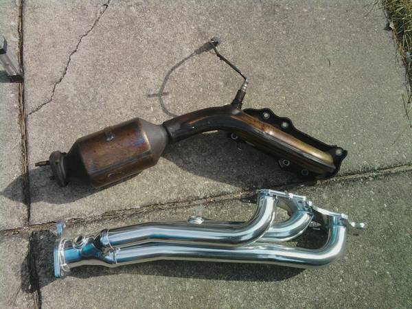

    My long tubes showed up over a week ago. As the story unfolded I had 2 AFR sensors 'welded' into my OEM manifold bungs. Both AFR sensors were ruined upon removal, despite PB Blaster and TLC.
    Fast forward to one week later...
    I ordered 2 new AFR sensors and had a good friend blast and retap the OEM manifolds. He polished the gasket face, added dust covers over the AFR sensor threads and I must say they look pretty darn good.
    Here's a picture of the cleaned up OEM exhaust maifolds next to the DTLT headers... which are BEGGING to get on my truck! :cool:
    The new DENSO AFR sensors showed up today and are in the long tubes, ready for a Saturday morning install. I can't wait to get my truck back!!! It's been an entire week w/o my Tacoma and sharing the Sequoia with the wife is getting old.
