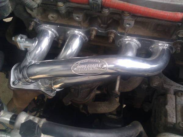

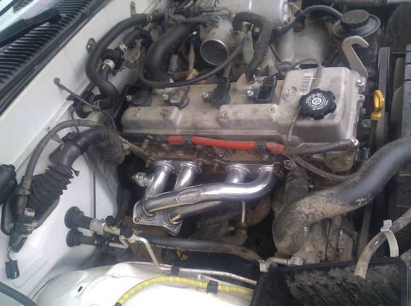

    Install Complete!!!!!!
    Took me about an hour to remove the original exhaust manifold and get it prepped for the Doug Thorley.
    The instructions say to remove it from the 3 bolt flange at the bottom of the manifold, but 2 of the bolts are a PITA to remove (20 min LOST right there). So I just removed it after the O2 Sensor and the first Catalytic.My truck has a 2 bolt flange there. I pulled it out from up top. Once out it was a piece of cake to remove that 3 bolt flange
    Just reverse the process and your done.. Took about 2 1/2 hours total to finish up. Im just waiting for it to cool down now and go re-torque everything.
    I don't work on cars very often but it wasn't that hard to do. I did it by myself, an extra set of hands would have been nice, but weren't available.
    Ill post some pics soon.

    Here are the PICS:
    This is a view of the bottom of the header. That is flange that I couldnt get on... 2 of the bolts are a pain
    2 Pics of it all installed from up top
