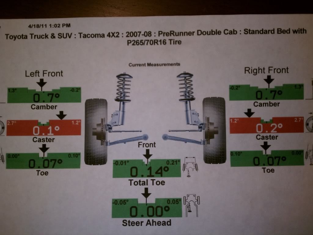

    Aha, so you guys have explained my problem to a T. After the lift (5100's from DSM, of course), my truck hates the road "hump" now and shoots off to one side or the other pretty quick. I've learned to compensate for it but still, it's annoying.
    Check out this alignment sheet from my post-lift service. This is what we're talking about fixing with these, right?
    I'm going to have to consider these, methinks...

    Correct. You're currently sitting at negative caster. The after market UCAs will get you back into the positive caster settings.
    Quoted from Tirerack.com: A very visual example of positive caster is a motorcycle's front steering forks. The forks point forward at the bottom and slope backward at the top. This rearward slope causes the front tire to remain stable when riding straight ahead and tilt towards the inside of the corner when turned.
