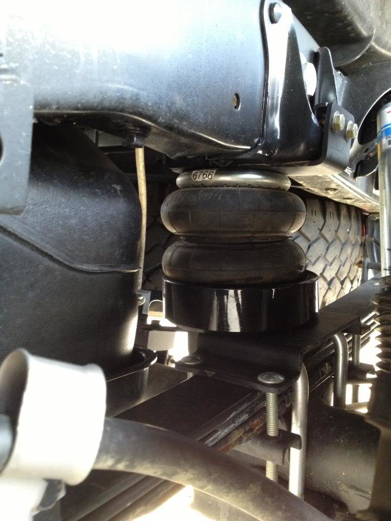

    I used a 2" spacer and I can tell that my up-travel is being limited because of this. I can feel the "bottoming out" sensation in the rear over large speed bumps and other bigger hits at speed. The front goes over them effortlessly.

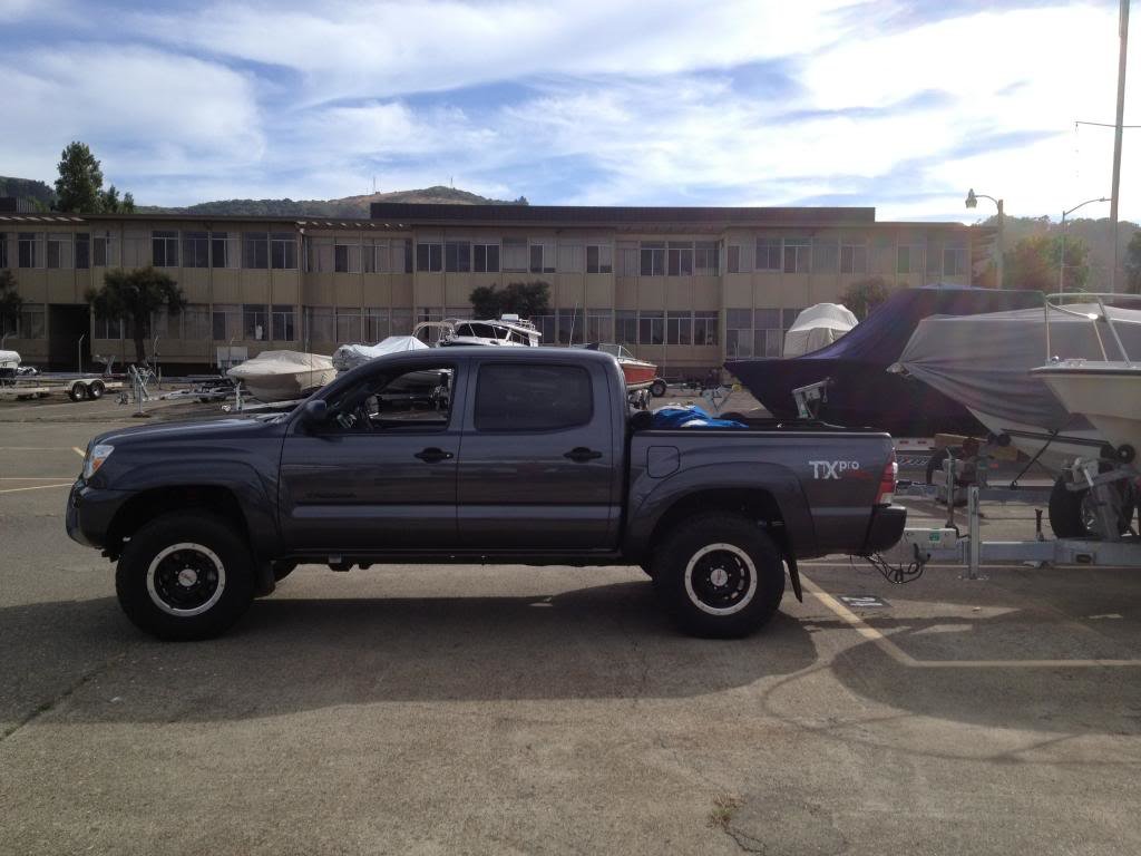

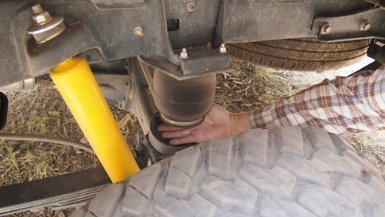

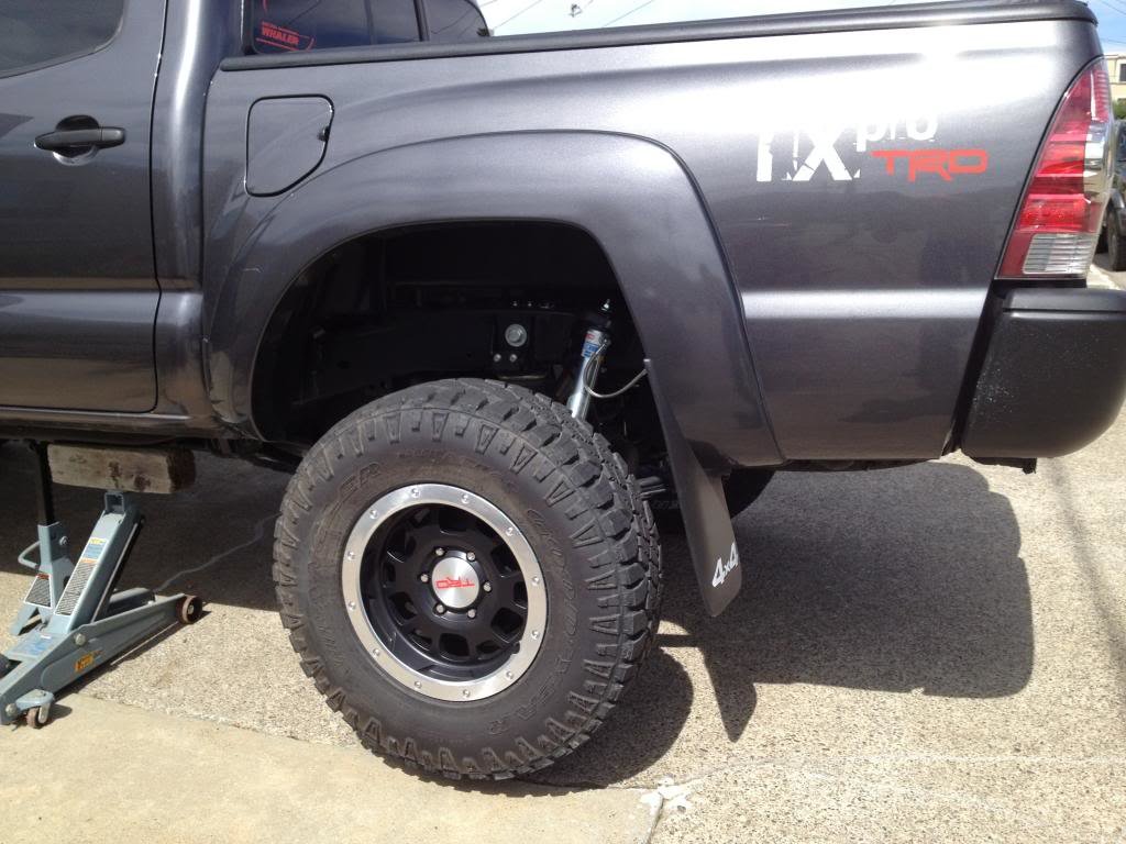

    Any pictures of your setups could be helpful too. At rest on level ground w/ min (5psi) in the bags might be a good reference.

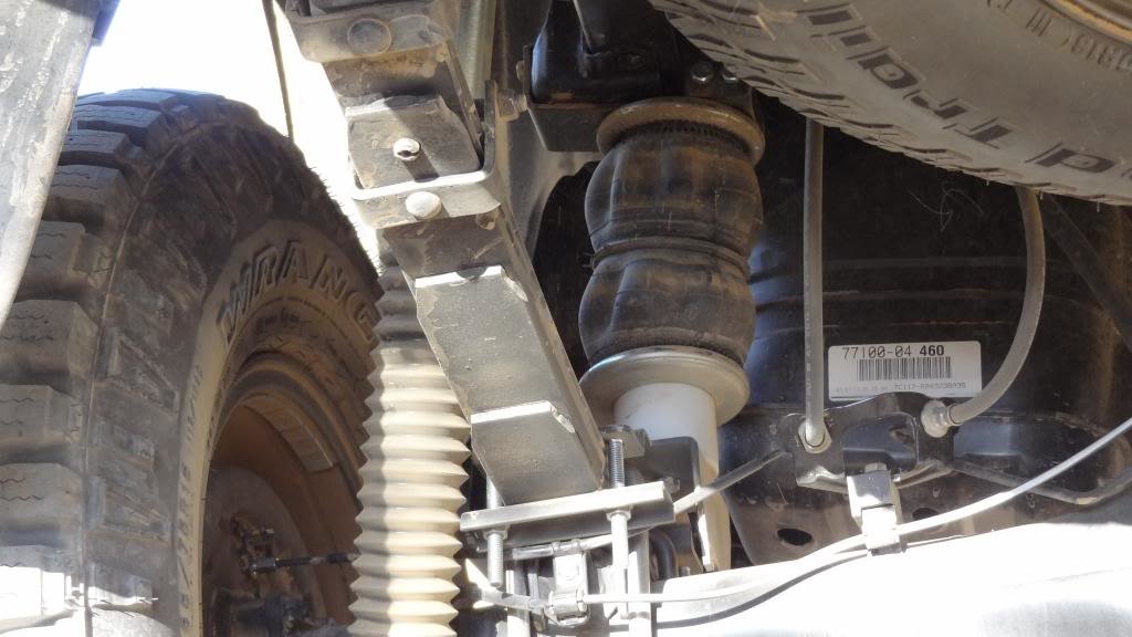

    Here is mine at rest and at full or close to full droop, I could not tell.
    25F7DCE5-CE0A-455D-A3DD-E13899A4A7D1-112_6ab80858282071e27a5f7983ac162f7e285e46d2.jpg
    The bag looks fully stretched here but when I felt it there was still some give, it was not as taught as it looked.
    05-26-13-IndianValleyReservoir_0053_zpsc_b36827c6362f8c4f853ebb6231461cdafc12e591.jpg
    I've emailed Fire Stone about this as well and will update the thread when I hear more information. So far I have been told that the bags will support the wheels at full droop if they are the limiting factor, as long as it's not a sudden drop (like a jump).
    Edit: Adding info from later post to main post

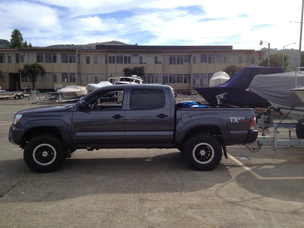

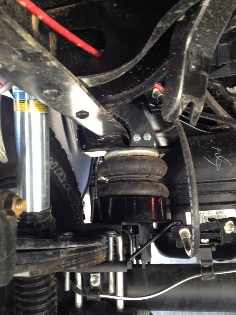

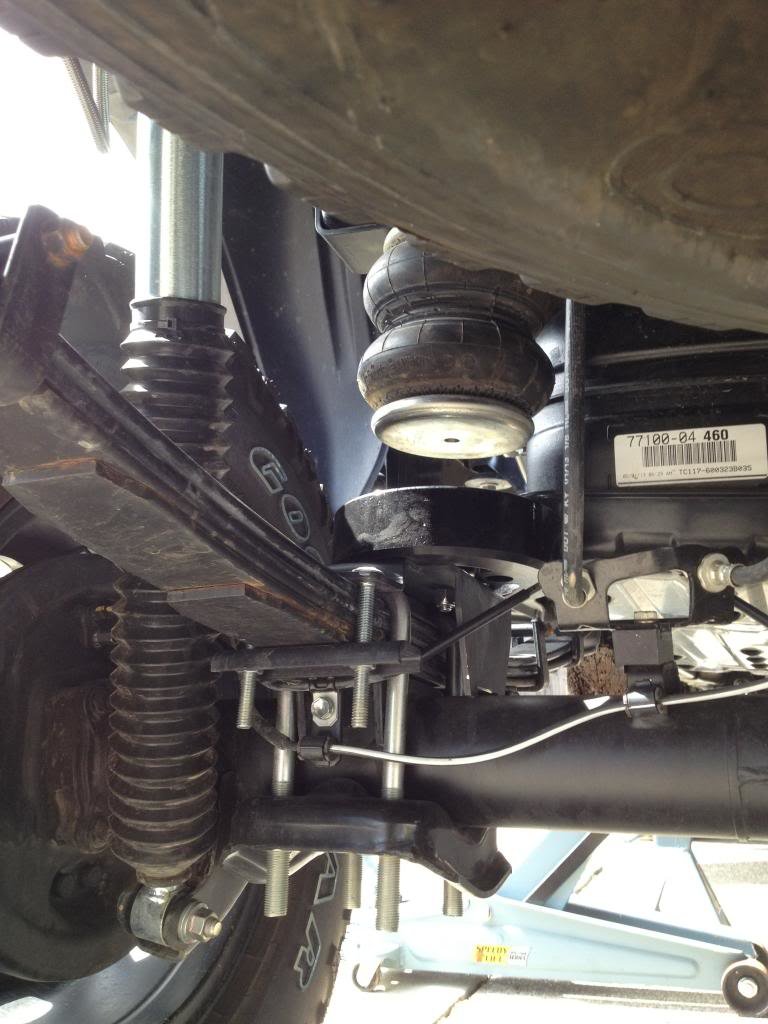

    Got the Daystar Airbag Cradles installed today. So far they are AWESOME. Removed the spacers completely, the cradles do rise up a bit.
    They only slight problem so far is that the cradle is not 100% centered so the bags are just touching the lip of the cradle. The material of the cradle is very smooth but I'm still worried about wear. I might try adding a strip of inner tube or figure another way to move the cradle a bit, not sure how I will do that though as the bottom of the cradle is vented (not ideal for drilling).
    At rest, no load, 5psi.
    Testing droop - 5psi
    Loaded boat - 0 psi
    Loaded boat 25 psi
    Loaded boat - 25 psi

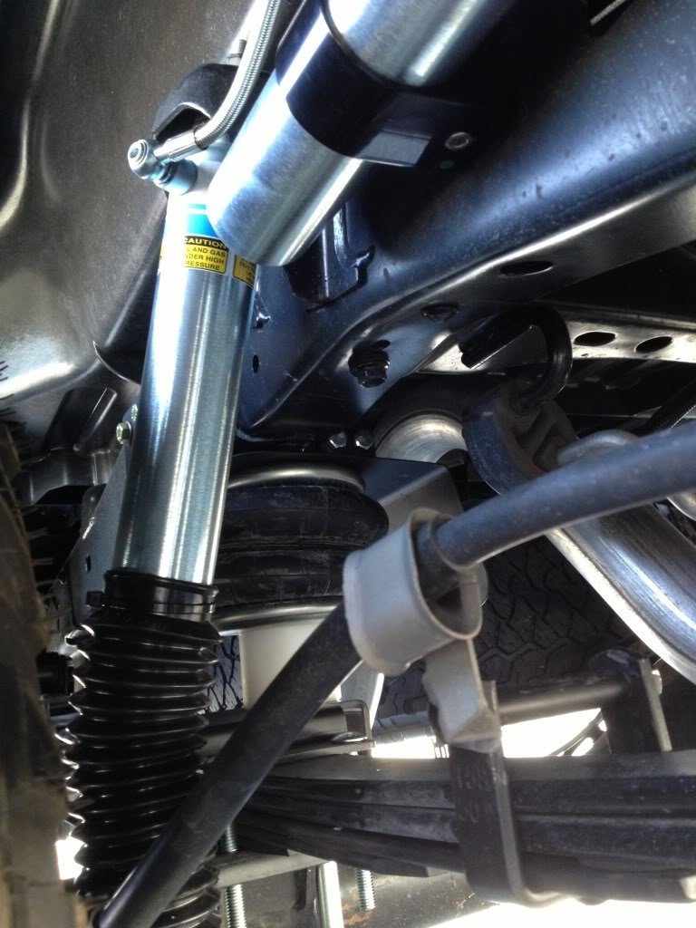

    Before
    A_u94JDimm1rvh6Bh4bGS16JNbyhFn-g8tvoC7Bc_489f4d5361f9790b0c071bf68281e02a826b195d.jpg
    After
    Update 6/25/2013
    I have managed to pretty much center the cradles and so far I'm not seeing any issues.
    I also got a chance to do some light wheeling over the weekend and everything works great. Ride is much better in the back without the spacers as expected and as observed on road.
