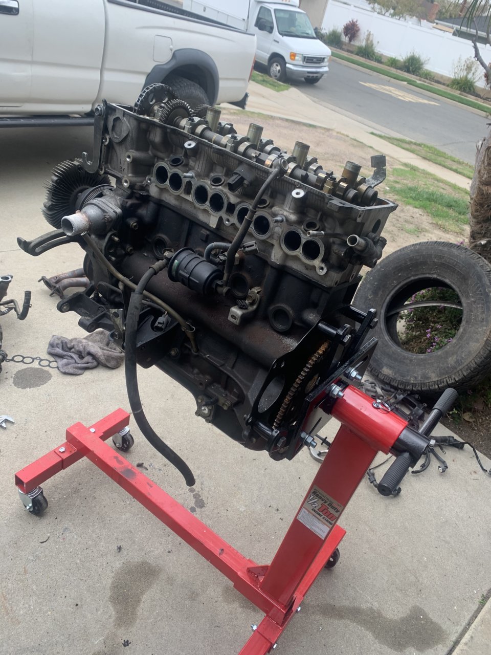

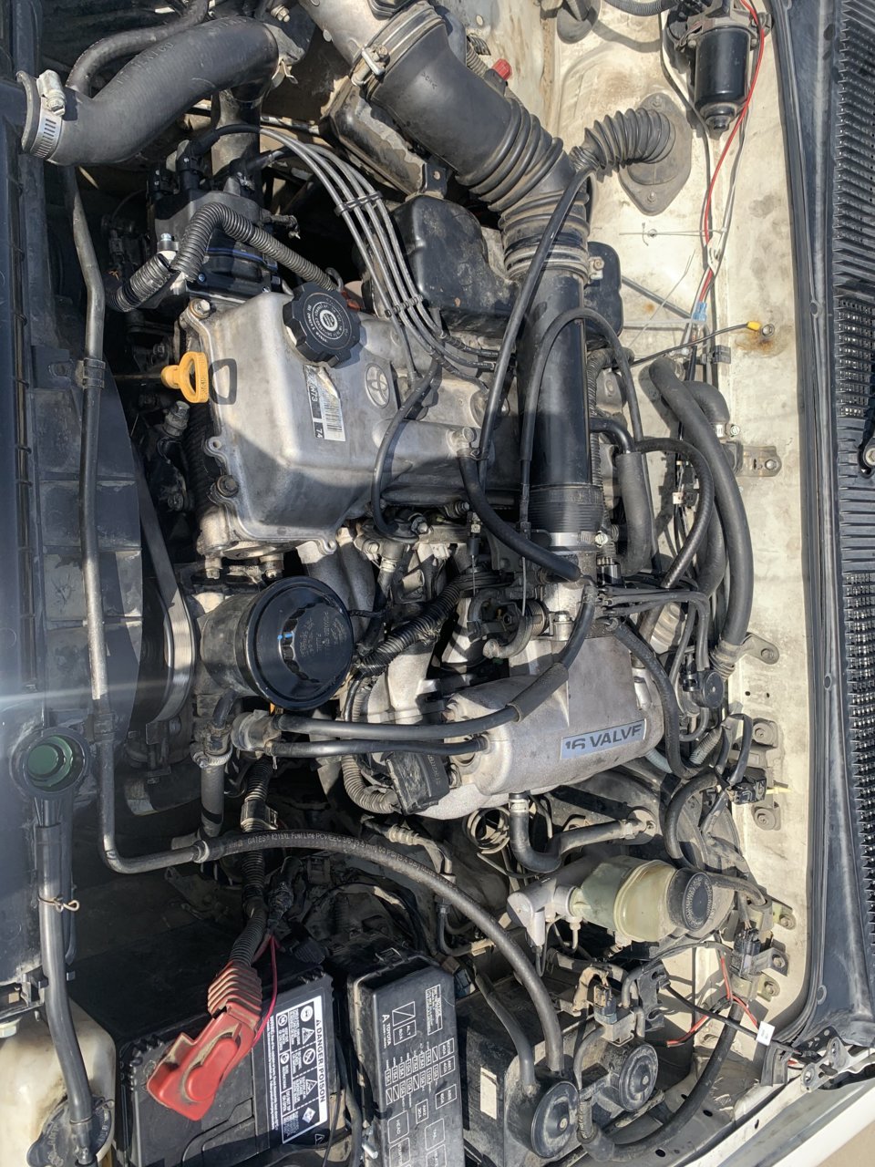

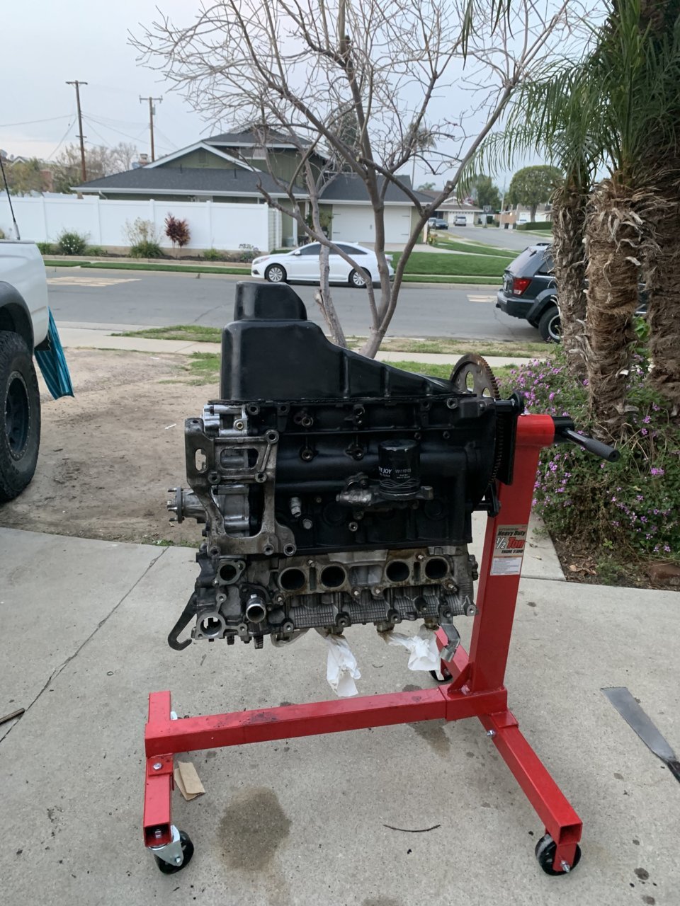

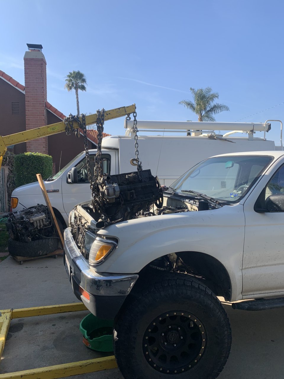

    this swap took me around 10 days mainly cause they weren’t full days on it, plus days for looking for the motor and getting parts. I did use their throttle body don’t know if it’s gonna be a issue so far not. I am only 10 miles in prob driven it around my neighborhood and down a few blocks. It idles well has good power. As far as I know right now I’ve got a good purchase going on. Here a few pictures of the swap
    A8563F0C-C3E7-4CBF-B4BC-724AA8FC8C53.jpg Old motor out
    EB485815-F80F-406B-95E8-E1510F69B7C5.jpg Assembling parts to jdm motor
    14BFB1F9-E6D1-4727-85B6-40AAC763247E.jpg Jdm motor in and everything together
    DE9A115F-1C5E-4468-A4F7-7A7DCAD530D5.jpg Putting on oil pan

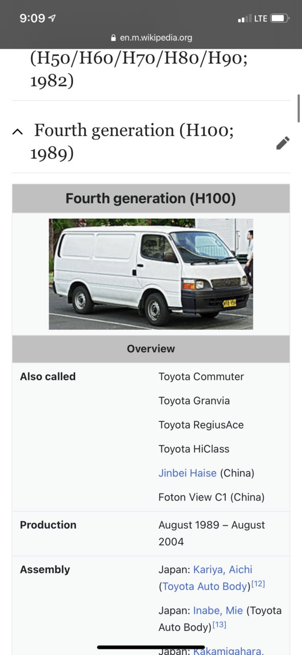

    For anyone curious as me I found where this motor came out of is a third gen Toyota hiace van 4x4 produce from 1989-2004 with the 3rz 2.7l. I believe the one I have is most likely in the early 2000s because it has the cam position sensor on the head which I don’t use cause I’m on a distributer.
