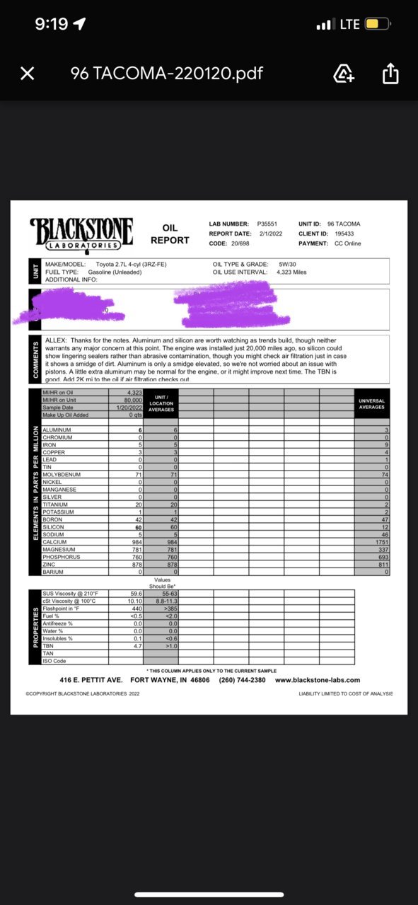

    Had a black stone lab test since I’m having a issue with my oil pump hitting something. Creating some aluminum possibly besides that everything is good 20k in

    You posted your full name, address, email, phone and everything :rofl:

    I remember when i first tw'd. Mods should delete the pic for now to protect him but meh lol

    It's not so much about a would-be thief trying to get into your shit (not difficult) it's more about a whole ton of others getting your info and advertising/spamming the shit out of you.

    I fixed it lol thanks
