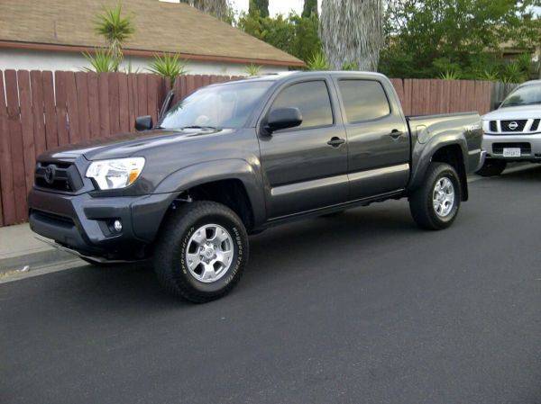

    installed the suspension today. debating about adjusting it up higher up to level it out.

    Nice...yeah, that's not cranked up at all. About 1.5-2" of thread showing should level you out.

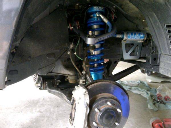

    Keep an eye on that resi tube. Looks really close to the UCA, but I could be wrong....hard to tell from pic. If it is close just loosen and turn the resi some and it should pull away....then tighten it back.

    it has just enough clearance but it is close haha.

    Cool it was hard to tell from the pic.
    Keep an eye on it. I didn't and learned the hard way.

    [​IMG]driver's side....passenger should be 1 less thread.
    also, what leaf pack are you running?that could make a difference as well as far as leveling out goes.
