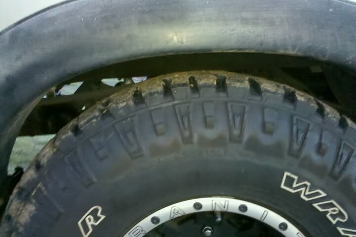

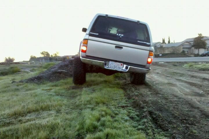

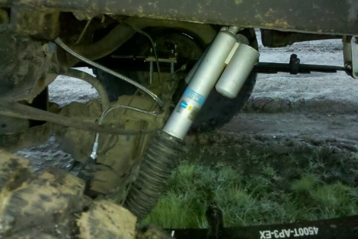

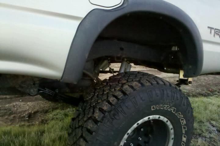

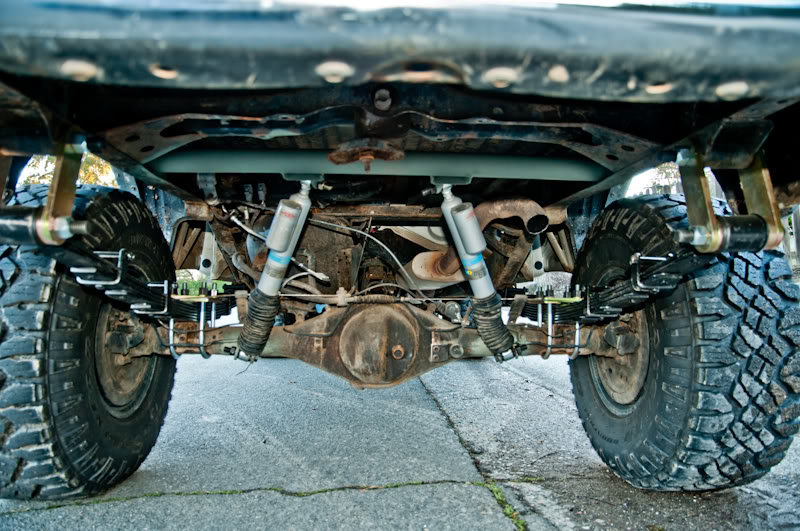

    I'm not selling them i went and flexed out and I have plenty of shock travel. With the angle of the shocks it's not 1 to 1
    This is full droop with the tire off the ground
    The shock is sitting at 6.7" extended
    I still have a little more up travel but I also have no bump stops on right now.

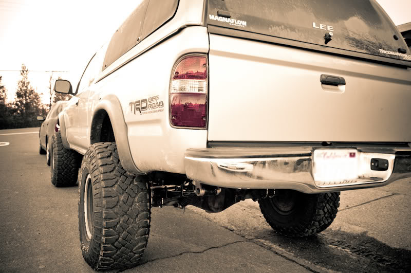

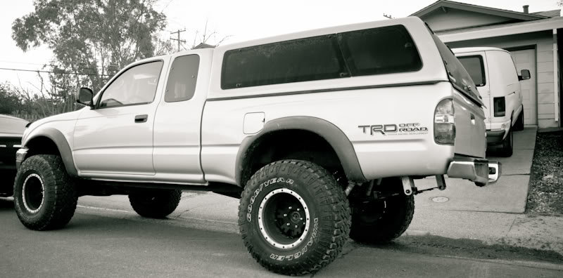

    And I really like the rake it has now not to high like I thought It would be.
    And here is a under shot I'm really glad I angled the shocks it rides nice and the look is pretty sick as well.

    Jerry, glad to hear the shocks still work for you. Are you thinking of getting new ones regardless, or just gonna keep these for a while?

    I just installed these in September so they are dam near new so I'll keep them for a wile unless I run into length issues when these leafs start to loosen up and flex more.

    Yeah from what I can see I still have 1 1/2" of travel left on the shock I'm going to flex the shit out of these on the 12th just to make sure I have no issues.

    I think Justin has longer travel shocks if you want them Jerry.

    I don't think I'm going to need them I'm going to do some more flexing this weekend when I install the bumps to see some more but I think I'm good
