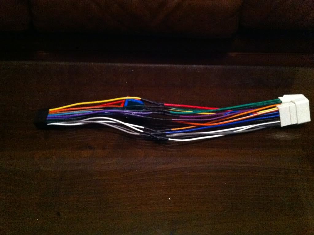

    dont feel like reading this group buy...but did the kit come with a wiring harness that plugs into your factory plugs with wires coming out the other side?

    If not..go to walmart or best buy or something and ask for a wiring harness for the tacoma... it will have a plug on one end..and wires on the other...similar to what plugs into the back of your unit yet this will plug into the truck.
    then match colors and splice the wires together..then plug in..and your done.
