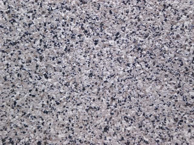

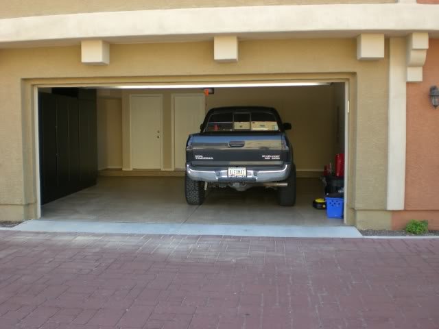

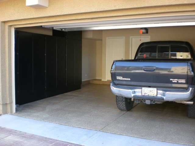

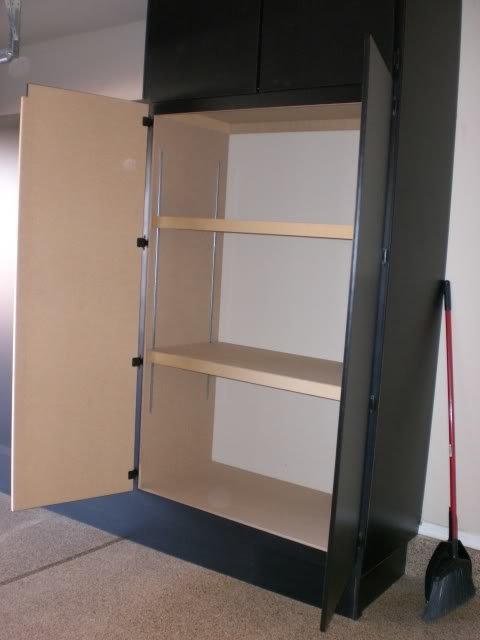

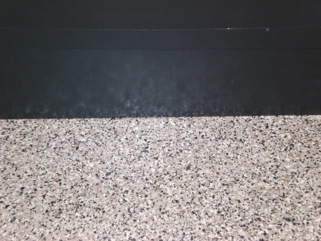

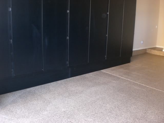

    I got custom Cabinets made today! :woot:
    I get my tool box and everything back in tomorrow. but here are some pictures from today.

    Holy cow! Do you have granite flooring in you garage? Baller!

    it looks it huh... my shop floor looked like that. not near as heavy but close to.. now it just flakes off when i sweep it. mine is fairly durable but right afterwards i prolly lost half the coating flakes when i would sweep it.

    Thanks a lot! I am very happy how it turned out.
    Haha no its not granite. Its actually epoxy coating. I coat floors on the side. Its 4 layers. a Water based primer epoxy, a solvent based top coat epoxy, epoxy flake and a chemical proof polyurethane. Its a lot of work but the end product looks great! :)
    Yeah this wont flake off because there is a chemical proof polyurethane over the top of the flake.

    :(^^^^ mine too. just a weak top coat

    Must be. The stuff I use when I coat floors is really thick and made locally. Its really expensive. $150 a gallon.

    That look takes 55 lbs of flake.
    It is made by a company called Veron Coatings. I use the 246 Clear and thin it out with MEK.
