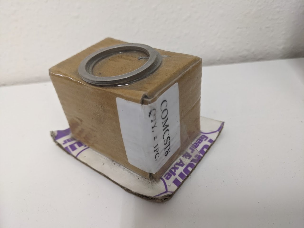

    For those interested, I have a PN:SK CST8 "Yukon Gear & Axle (SK CST8) Crush Sleeve Eliminator Kit for Toyota 8 Differential" that I'll let go for 25 shipped if anyone needs.
