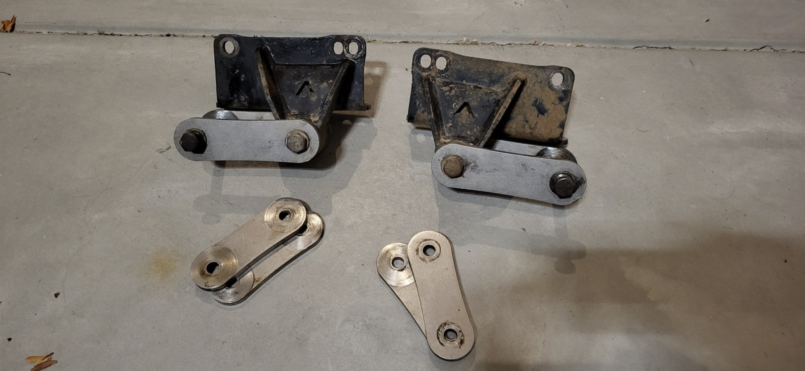

    Littles
    Littles Stupid is as stupid does.
    May 14, 2014
    #129837
    3,342
    Bryan
    Elizabeth, CO
    3 tons of fun
    @TacoTuesday1
    @andthen

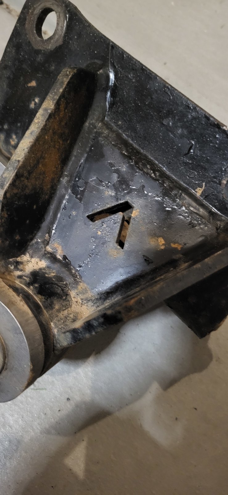

    I have an old archive garage shackle flip with two sets of shackles (4" and 4.75") that I'd be happy to get out of the garage, if either of you are interested. They arent free but i am motivated to move them for less than youd pay for either of the above new. It seems like fewer and fewer people are doing shackle flips with what the new hammer hangers can do for the same price.
    Edit: added photo. A little dirty, but a fresh coat of paint and maybe some new bushings and these are good to go. Eric makes really good stuff.
    I ran the archive flip with OME dakars and later with custom alcans, both paired bilstein B110 5100s if I recall. I came up from a basically stock rear to the dakars/b110s so it was overall a huge improvement for me and I can't really say I noticed a major change in rear stability, but I also wasnt looking for it as I was focused on off-road capability and droop at the time. I am sure there is more roll compared to stock or hammer hangers through turns, all other components the same, but whatever difference wasn't that big of a deal for me. I knew going into it that it wouldnt drive the same and I just adjusted my driving habits. I never felt like I did not have control of the truck, even hitting canyon roads hard.
    That said, if the newer aftermarket hammer hangers you can get now had been out back when I first did my suspension, I'd probably have gone that route, and in retrospect probably should have swapped to hammer hangers when I got the alcans, because they were readily available by then. Might have been happier with my alcans if i could have gotten more droop. People seem to be getting as good or better numbers out of the hammer hangers than I got out of the shackle flip with either leaf pack.
    I know I am not making a great case for getting crap out of my garage, but just trying to give an honest perspective based on my personal experience.
    andthen and Windigo like this.
