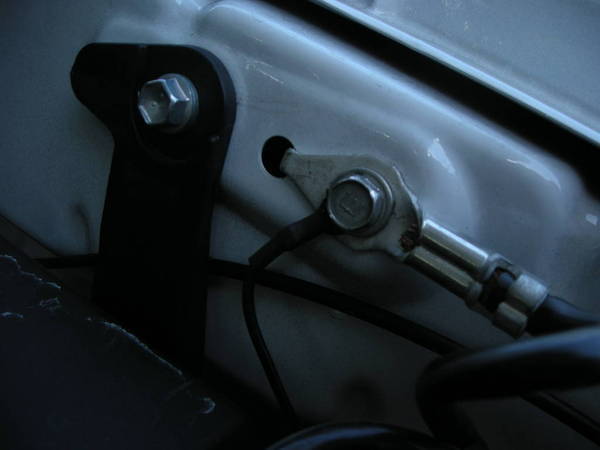

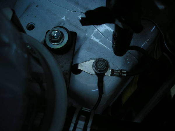

    thanks for this write up, i just got and installed mine from slim. cant wait till it gets dark out. your write up helped out a lot..... by the way do you think that i chose good spots to ground heres a few pics.... they seem to be working fine, they are factory grounds that already have other grounds applied to them. thanks again!
    driver side
    pass. side

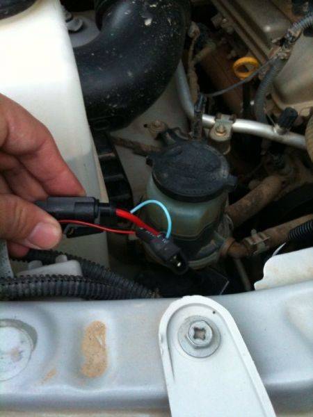

    Like where the hell does this plug in to?
    I don't see anything. :confused:

    I just realized that's the relay connector. There's nothing to plug it into though. :confused:

    Idk man.. my stuff was all really obvious what plugs into what. I guess look at your wire harnesses again maybe you missed a connector?
