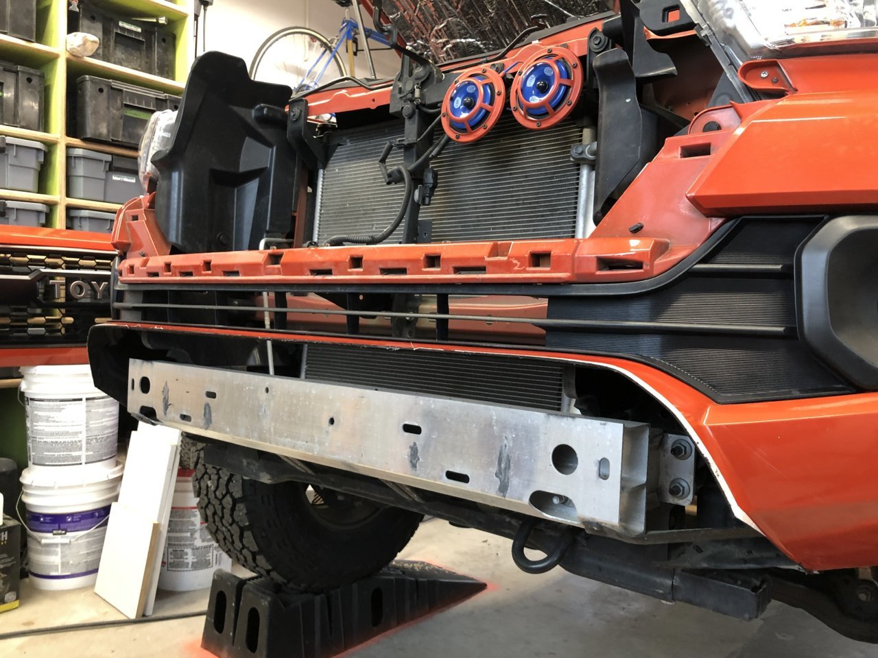

    Does this look right?

    That looks perfect. Remember, you can always take more off but you can’t put it back on. And don’t rush it either. I did not follow my own advice and I took a little bit too much off.

    Go 1/4" at the side right? Then not worry about the side since I got the Stage 2.

    :thumbsup:Dead on, a little gap that only bugs the hell outta of me because I know it’s there.
    Now I have no choice but to do Stage 2, dog gonnit.

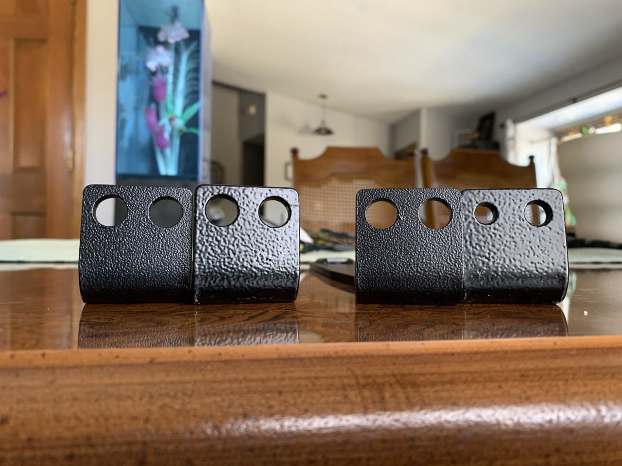

    Can someone post a picture of their correct fender brackets?
    Did they match the holes on the bumper like the one on the far right in this pic?
    I just received my replacements and they are ~1/2” longer than the originals but the holes do not match up...

    Mine had the bigger holes in the bracket, but the holes in the bumper were like your pic.

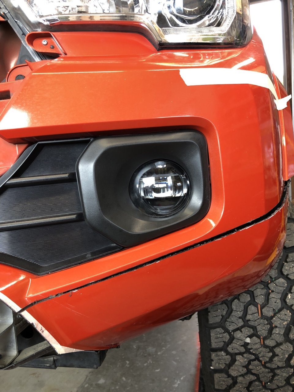

    Doe this mean I have to cut more?

    Like the others, I had to use the six factory nuts since the supplied nuts were incorrect. My fender brackets worked without a problem.

    That picture is of the originals and the replacements. According to SSO, the ones with two different sized holes (that actually match the bumper--the one on the far right in the picture) were incorrect older versions that "should have already been thrown out". Seems counterintuitive but I'm done going back and forth with them. When I questioned the smaller bolt that would match the bumper vs the larger hole on the bracket they advised to use washers (that were NOT in the original, second, or third hardware shipments that I received).

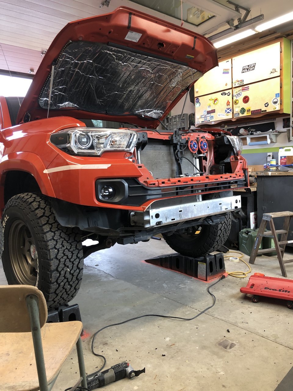

    #23 on the list. Bumper is scheduled to arrive via FedEx tomorrow so I pulled the truck into the garage and cut some plastic off.
    So far so good.
