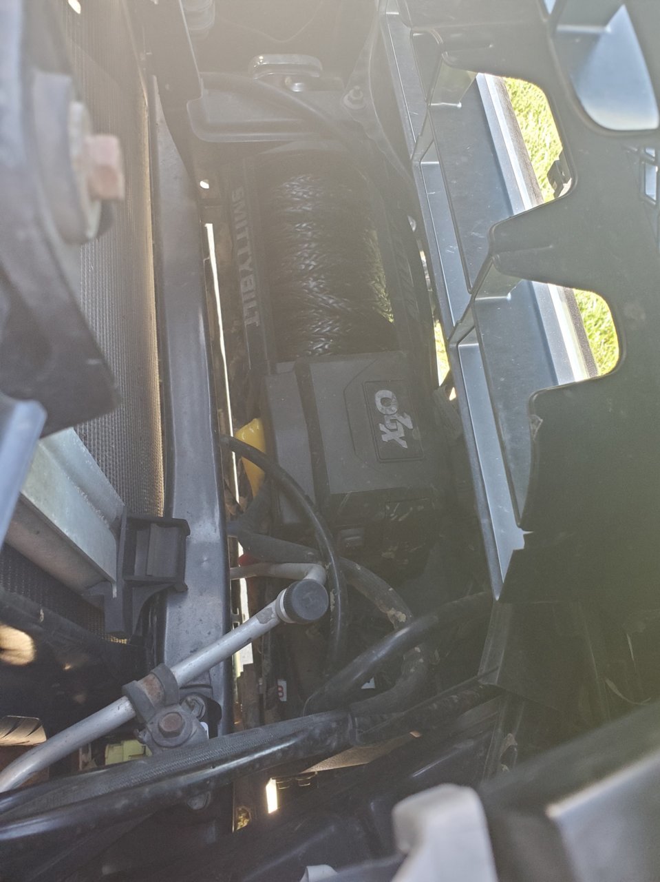

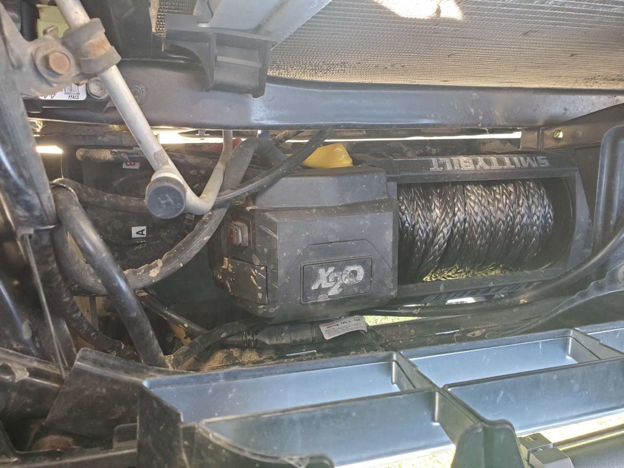

    Correct! X20 with the synthetic line. The solenoid fit right in the included mounting plate that goes above the drum. I can get a picture of it tomorrow morning if you want. I didn't mention it in my other comment but I have a 2015, so the fit might be slightly different on 3rd gens. I think it would still fit though, there's more room up there than you realize.

    Hopefully this helps! The solenoid box sits on the top left side of the winch and fits in there snuggly. I didn't need to alter any additional supports or coolant lines or anything like that. I can still reach the button on the side to switch from wired to remote control operation, and I can still reach the clutch on the opposite end of the winch.

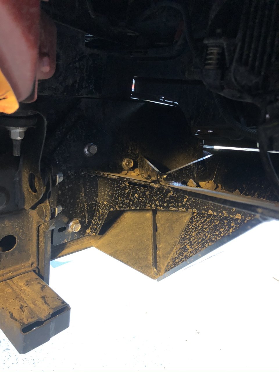

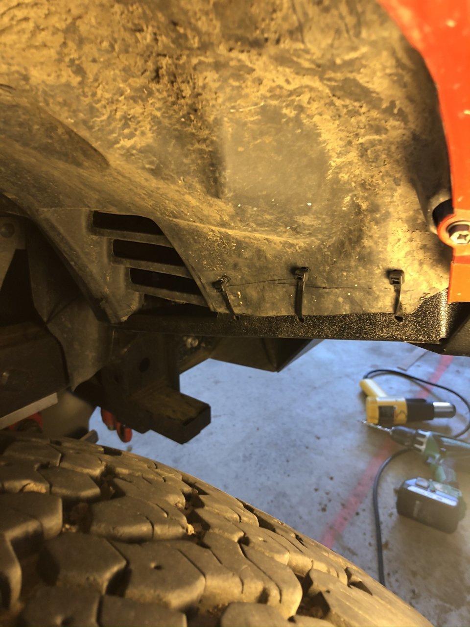

  14. Aug 17, 2020 at 7:47 AM
    #474
    Stopmithering
    Stopmithering Well-Known Member
    Oct 5, 2016
    #199003
    398
    Stuart
    17 Tacoma TRD Sport ACLB MT

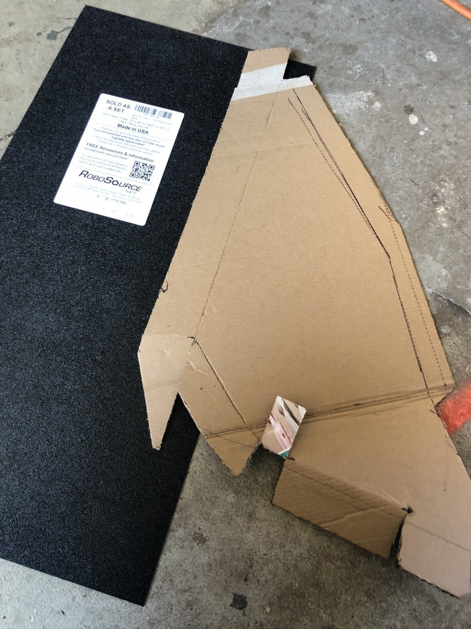

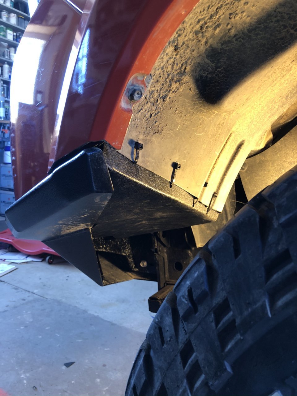

    I thought you guys might be interested. I was not liking how you could just reach in and grab the backside of the fog lights. Also rocks where starting to collect in the back side of the bumper, so I made some covers out of 1/16 ABS sheet. Heat and bend with a heat gun over the edge of my work bench.
    Of course you can still reach in and grab the fog lights, but at least the temptation isn’t there.

  15. Aug 20, 2020 at 3:55 AM
    #475
    Ch78
    Ch78 GBO!
    Apr 22, 2016
    #185006
    2,334
    Tomball, TX
    25’ Landcruiser 1958
    Tuned By D3 Performance
    Your post is a few months old but I just saw it. There’s a better solution for this problem so you don’t have to reach in behind your grill and fight that battle every time you need to get to your solenoid box. I have the 3rd gen Maner amount from Tandem Off Road and it makes my life a lot easier.
    3rd Gen
    https://tandem-offroad.com/collecti...r-mount-3rd-gen-tacoma-winch-controller-mount
    2nd Gen
    https://tandem-offroad.com/collecti...t-2nd-gen-tacoma-05-15-winch-controller-mount

    I suggest doing something like this because I have my control box mounted on this side and it's now come loose. I think the only way to tighten it is to complete take the bumper out

    I am guessing you need to extend the leads to make this work tho

    I didn’t need to.

    I made mine with some scrap aluminum. No wiring changes needed.
