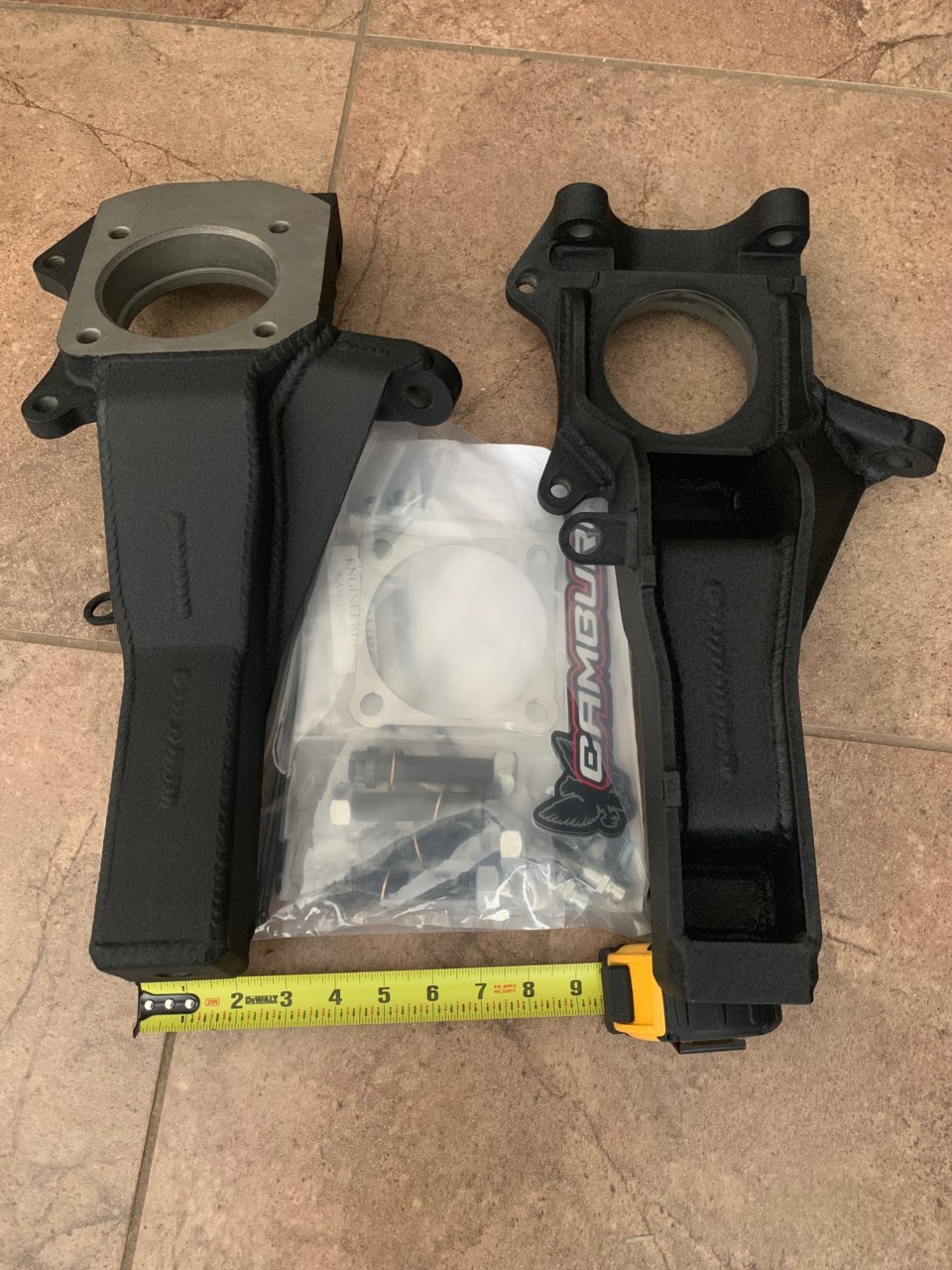

    Baja Action Drone
    Baja Action Drone Do cool stuff, rinse and repeat!
    Apr 29, 2018
    #252033
    61
    Gregory
    2021 TRD Off Road Access Cab
    Front ADS 2.5 Coil overs RR w/Clicker. Rear ADS 2.5 piggyback, Camburg 1 1/4 Uniball UCA's,Camburg LCA's Camburg Performance Spindles, Deaver U401 Stage 1 Leaf Pack, BAMF Greaseable Shackels, CaliRaised Rock Sliders/Overland Bed Rack, Method 305 Wheels, Borla S-Type Cat Back & uuuuh, various Pods, Light Bar Rotopax..........
    Haha I love it! I'm reading through some threads getting ready for install of the new stock length Performance Camburg spindles. I pick up some great tips here, but I also get caught up reading through some of the "silly" stuff. Thank you all!!file-2.jpg

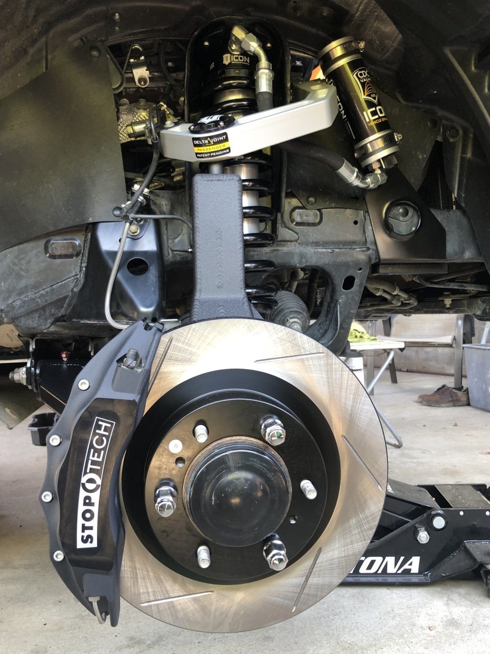

    91Bravo
    91Bravo Well-Known Member
    Aug 22, 2016
    #195273
    232
    Van
    Bay Area
    16Tacoma4x4TRD
    Do you just finger tighten the upper control arm nut??? Anyone able to tighten the 21mm nut with a tool??? IMG_6011.jpg
