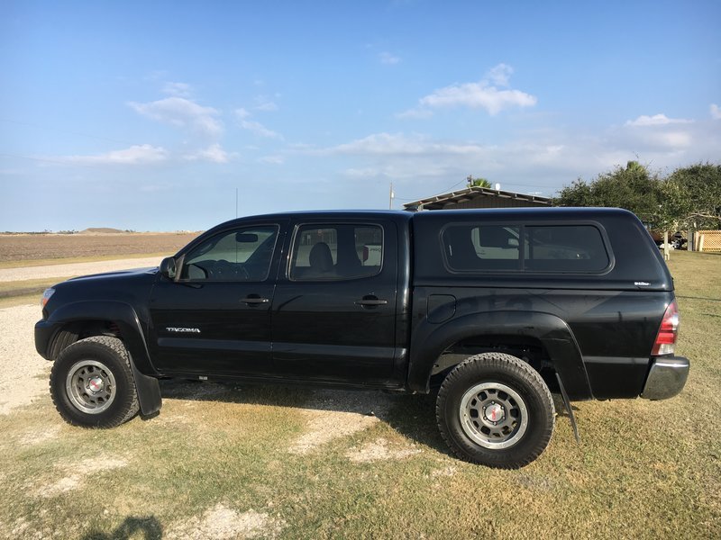

    New here, lurked a little bit before I bought a black 2012 Baja last week. Love it.

    Good man. I would of gotten the black one if they had it in stock at the time. WE NEED PICS!

    Welcome to T. World!
    Prepare yourself and wallet! :cheers:
