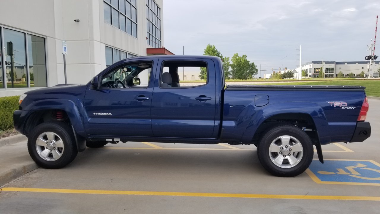

    hey tacoma trd pro users, I just recently got the PTR13-35150 installed, and I also got the fabfours bumper installed as well. When I got my new frame installed due to the rust, they installed the shocks/strut but my didnt come in time.... Toyota installed the shocks/strut, 4wheel auto parts installed the bumper
    Now measuring such, they say when I get the progressive lift, I will only get a about 1/4" lift from truck level. My question is, what is the natural rake of the Tacoma for a 2nd generation 2007. I would like to get my tacoma back to the normal oem rake. I'm not sure if 1/4" lift rake is optimal. At most I load my sv1000S motorcycle on to my truck or haul stuff in the bed, but not really towing. But I like to know that when I tow in the future (state to state for relocation), I will not ever have an issue.
    They will be installing the lift this 9/13. They said maybe I should look into 1" block spacers. What are ya all opinions, I have no clue about this and I dont offroad at all. I looked and searched thru the forums but with so many postings I got discouraged.... Please help.

    To clarify, we are TX & TX Pro owners. Without getting into the major details, the packages are different than the TRD Pros. Biggest difference is suspension where our suspension is more like the TRD Off Road package and the TRD Pros are bigger and better. I'll ignore the Baja package for sake of arguement.
    As for your situation, and this is just my opinion, if you were ONLY worried about rake and wanted to lift the rear, a small spacer block would be the most economical option. BUT since you are talking 1000 lb loads, I would seriously consider upgrading the springs with an add-a-leaf (AAL) spring. This will slightly increase the height as well as beef up the suspension and avoid major suspension and payload issues.
    Just my thoughts.

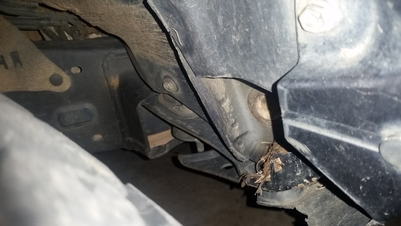

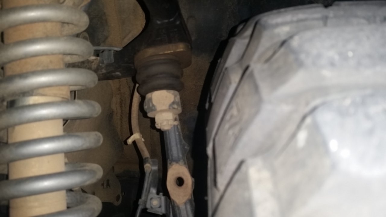

    Alright! Nice build. do you have any pics of how close the tire comes to your UCA? and have you done cmc?

    Thanks man.
    Fresh pics:
    I need to quit being lazy and plate the cab mount :rolleyes:

    Please excuse the shit plastic trimming job :anonymous:
    And don't mind the junk stuck next to the pinch weld...... like i said... lazy :cookiemonster:

    BOOOM! thanks! thats all I needed! just ordered my 285s!
    BOOOM! thats all I needed! just ordered my 285s! Thanks man!

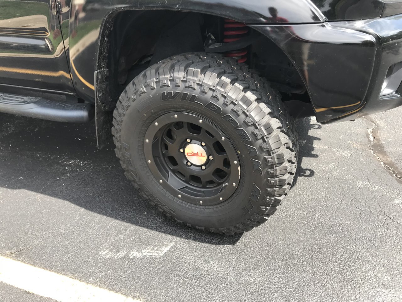

    With all this tire talk, anyone put 265/75/16s on their TRD wheels? It's only about 1.5" diameter increase, but looks like it would still require CMC.

    :thumbsup: :spending:
    And now I know my next tire size.
    Edit: I also like the look with the blacked out beadlock ring. May have to steal that, too.
