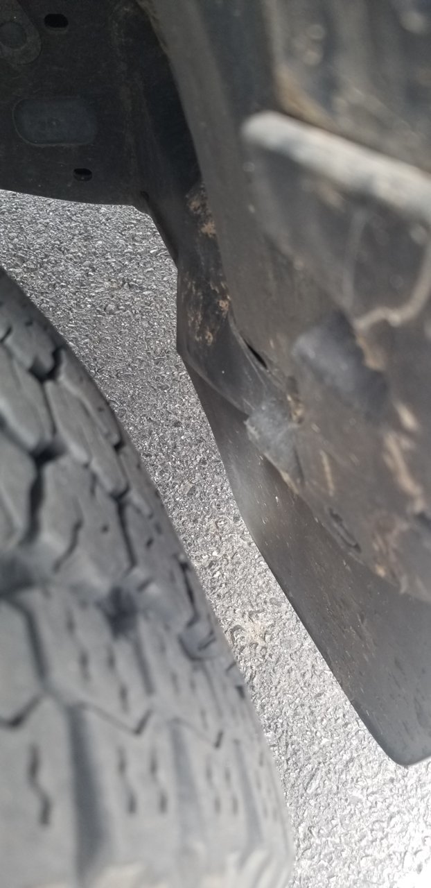

    I'm thinking about lifting the truck from it's stock suspension another 1". There are conflicting reports on what the stock lift is at on a 2012 TX Pro.
    The cheapest way about this is to add small spacers in the front and a leaf in the rear to level the truck. Just not sure the stock struts will stretch any further.

    are you opposed to pulling the mud flaps off? Also, have you had a alignment lately? If your caster is to negative, that can cause tires to rub.
    you can get a 1" inch spacer for the front that goes on top of the coil top hat. The struts don't need to come apart. They just slide in between that and the coil bucket. Most people hate on spacers (I'm guilty too :anonymous:), but it's an inexpensive option that will work for what you want to do.

    I would just remove the mud flaps.

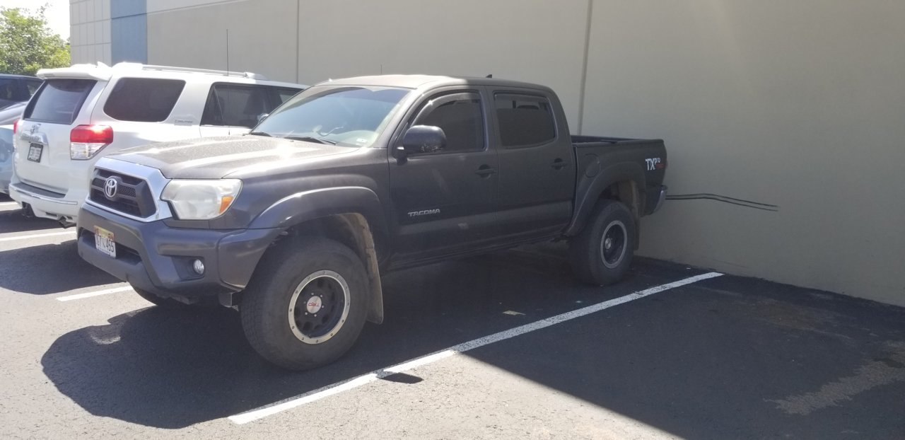

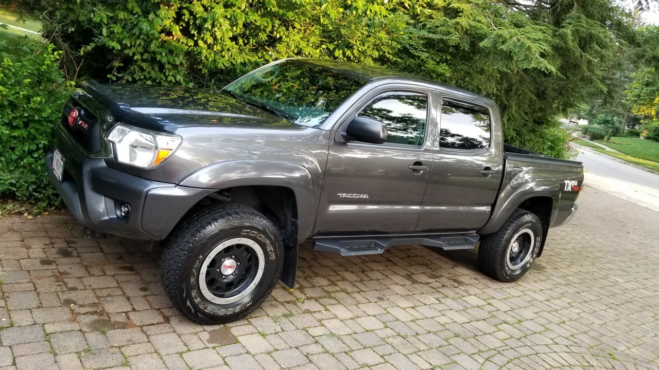

    Here's a quick pic

    Nice!

    Let the mods begin for you two!!!

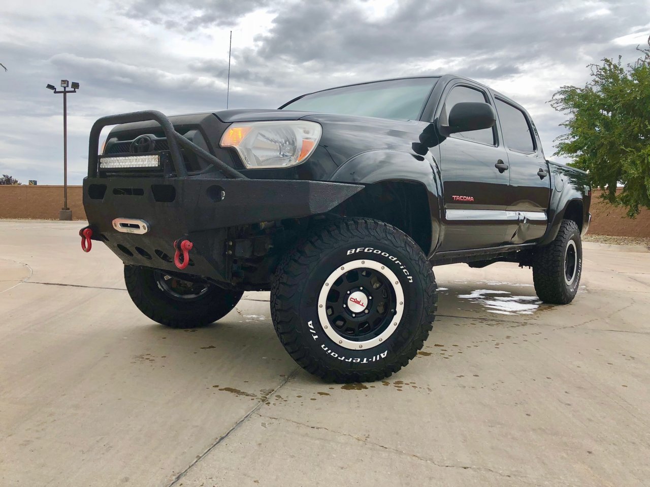

    Looks good. What suspension you running?
    Also, needs dirt!

    Front: Bilstein 5100 with Eibach 620 springs. I'm sitting about 2.5"
    Tuff Country UCA's
    Rear: Toytec Boss with 2" AAL
    Replaced the sway bar linkage with Moog.

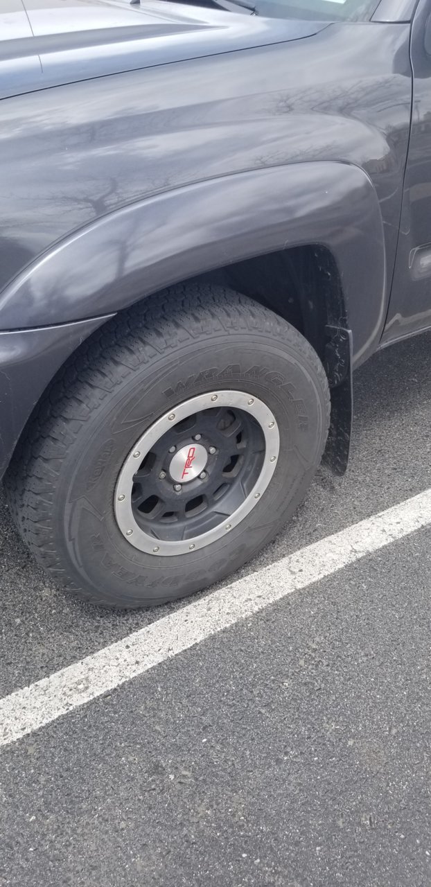

    Nice clean truck! How do you keep your headlights clear?

    Thanks! I had just washed it.
    I haven't done anything other than washing it. I'm surprised, too. It's a '13 and still not showing any UV damage on the lenses.
