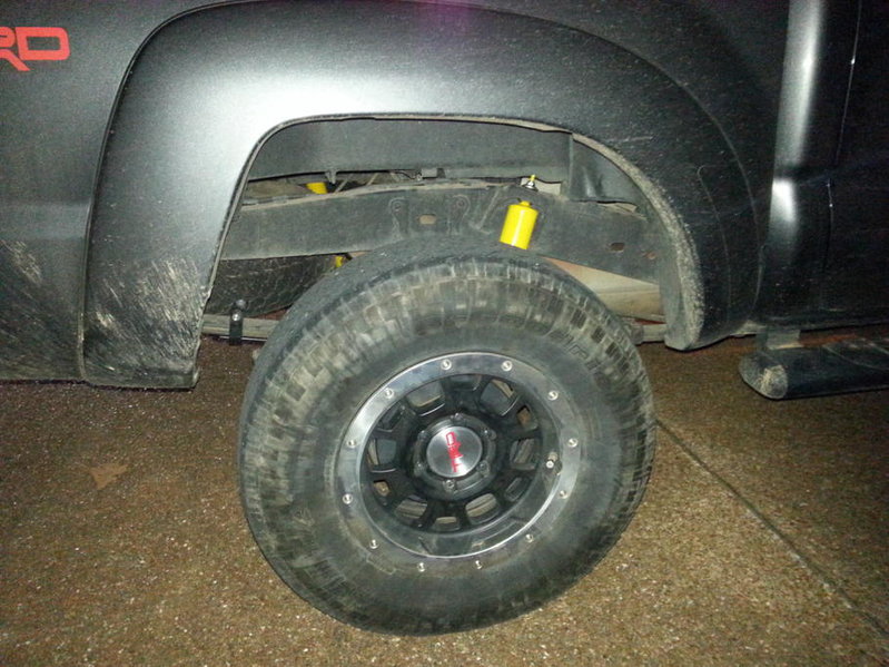

    I cut my rear thin sheet metal fenders. Once again ...... what sharp edges?

    The more I sand it the more it's causing the paint to chip so what do you suggest

    Dremel tool with a sander on the end of it and don't stay on one spot to long

    I did that and it cut throug the sanding wheel. I didn't figure stone would work too well

    Try it! What's it gonna hurt?
    I did mine with my dremel tool

    Do you have a grinder? Use a sanding wheel. That's what they are made for. I used a 1200 grit I think. Stop with that dremel crap. A stone is not made to smooth sand anything

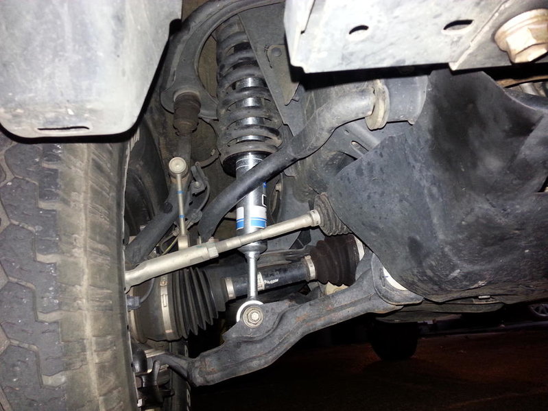

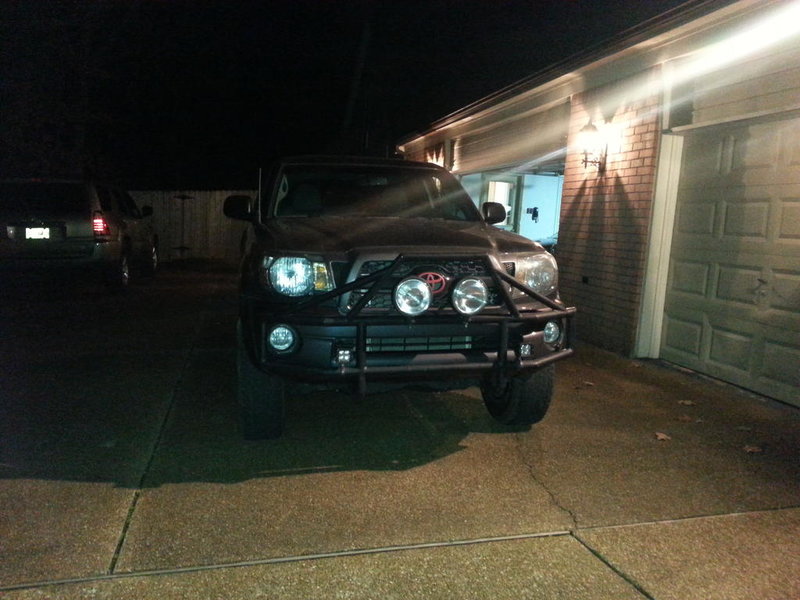

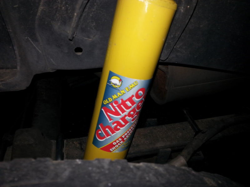

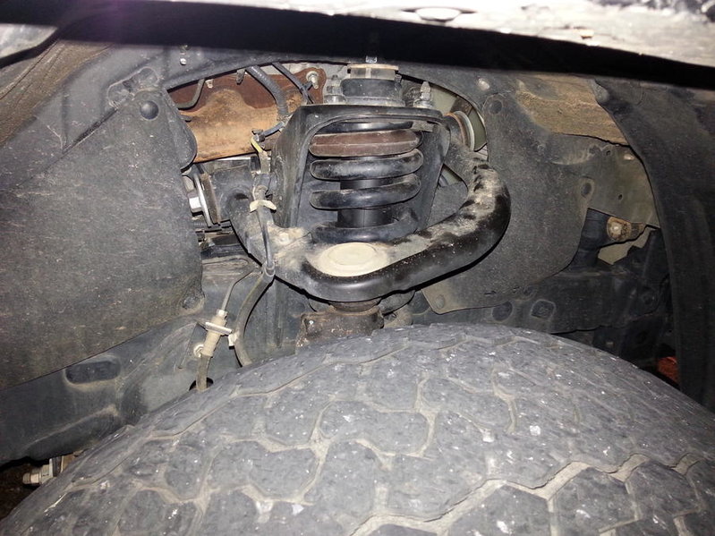

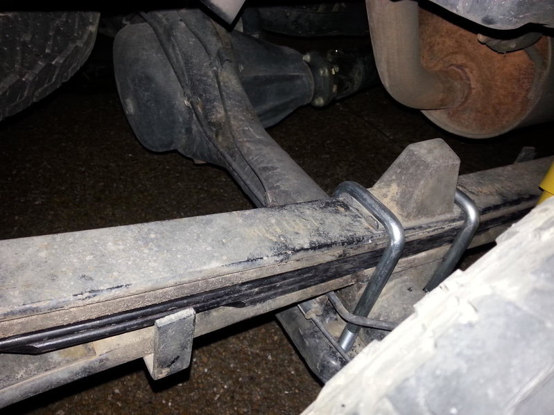

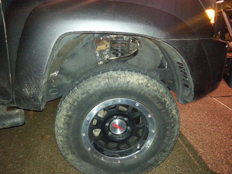

    It's done! I'm finally lifted! :yay: big thanks to gid for helping me with the rear.

    Thanks guys. Fronts are 5100's on stock coils at 2.5. Rears are OME N182's with wheeler's HD progressive AAL with overload leaf left in. I would say the ride is firm, not stiff... but not bad at all.
