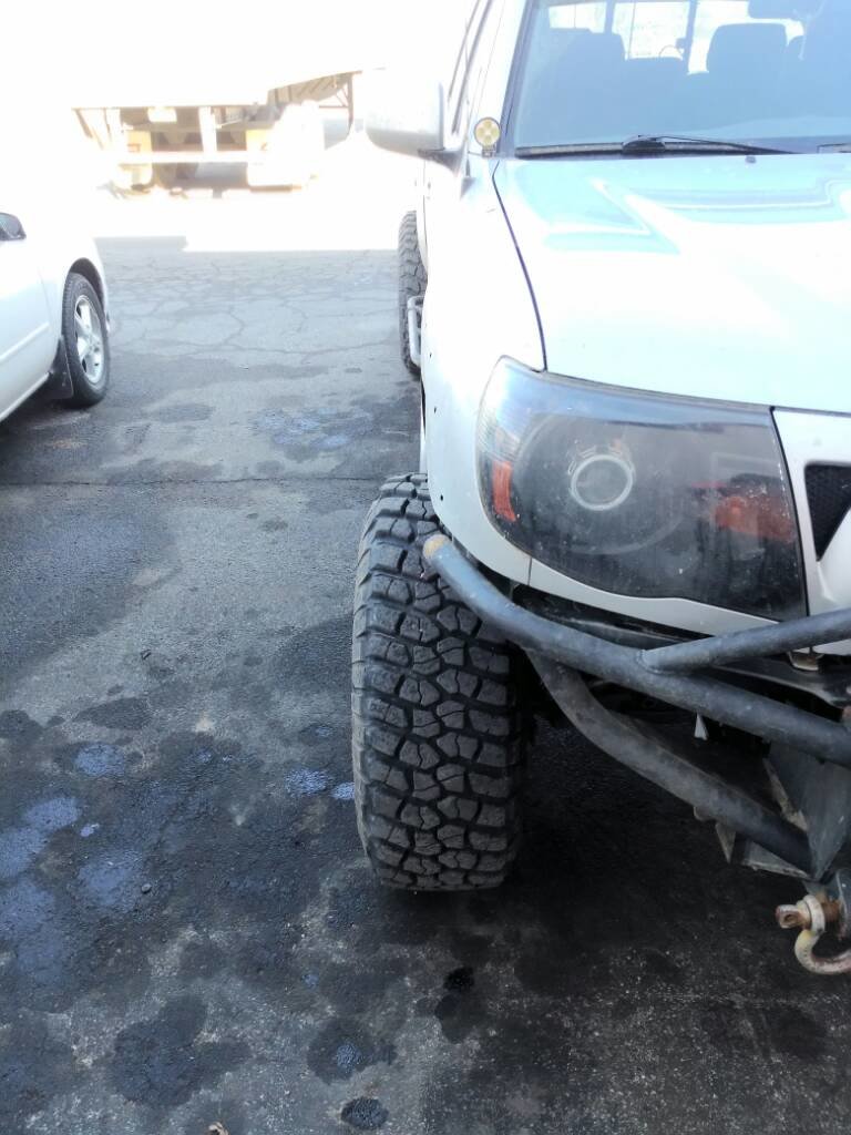

    Here is my stance with 1.5" wheel spacers and 4" b.s. wheels
    265 on stock wheels top and 315 with a 4.5" back spacing bottom.
