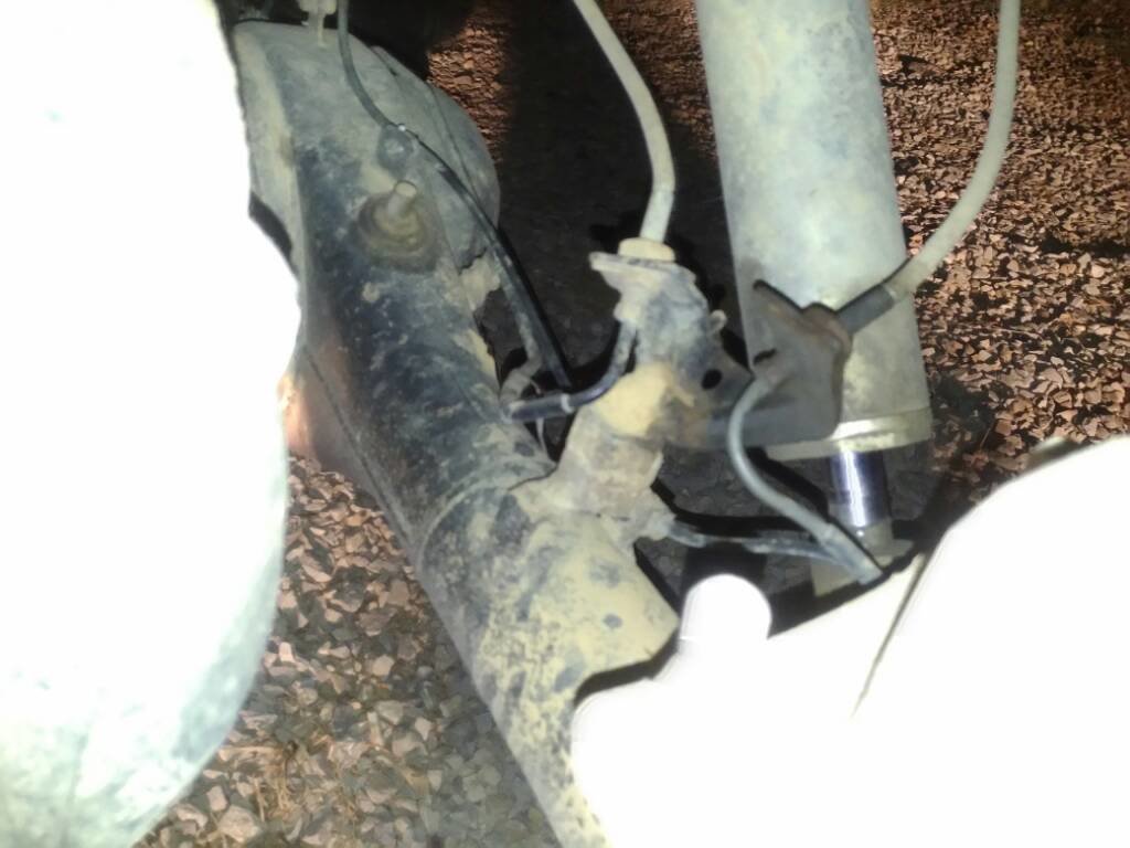

    Unbolt the clip that holds the brake lines to the axle bend it up a little and weld an extension from the bracket to the axle... that's the cheapest way and you don't have to undo your lines
    But probably isn't the best way haha

    Just bend the upper bracket down. That's what I did with allpro standards and stock location shocks. They were like 9.75" or something. Take some channel locks and bend them down some. It may not look like much but an extra inch of brake line towards the center of the axle is a lot

    Here's how I did mine plus one have extended brake lines

    So you don't have extended brake lines on yours?

    I do but then I did my shackle flip kit I bent the bracket as well
