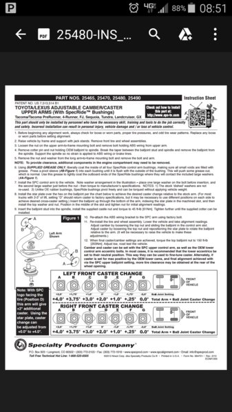

    Yeah. That's the sheet I reviewed with each tech. I'm on A, both sides. Even highlighted the bold above the diagram that you can move the LCA forward then set it with the UCA. I had a lot of confidence in the last tech. Didn't get to talk to him afterwards but I'm begin g to think something about my lift being closer to 4" than 3" (......:anonymous:) has something to do with it. May also be causing the premature BJ wear.
