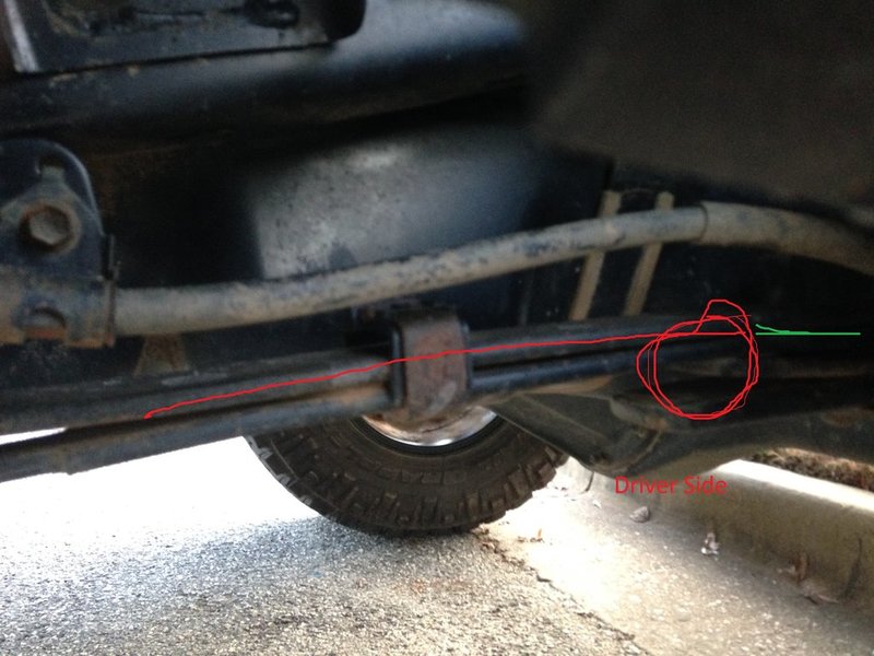

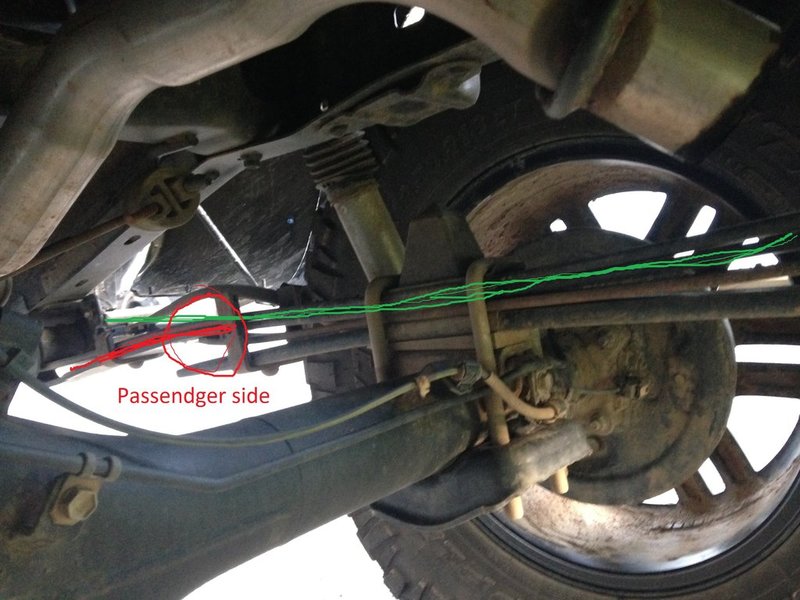

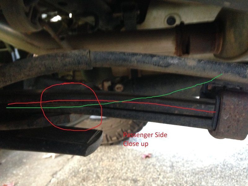

    Headed on some trails with guys from Columbus, good scenic riding.
    Some pics are here: https://www.tacomaworld.com/threads/anyone-in-the-columbus-ga-area.307887/page-13#post-11202893
    A vid one of the guys got: https://www.youtube.com/watch?v=Rj7bV9Xr_rg
    My rear suspension is totally shot. Once I lock in what shocks I want (Fox 2.0 IFP or w/ Resi) I'm pulling the trigger (prob wait for blackfriday deals of course)

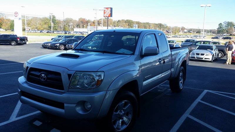

    Only one I got right now, I'm gonna take a few others tomorrow. As far as I can tell, it's completely stock. The guy traded it in on a 2016 tacoma.

    If your springs are actually shot I wouldn't waste money on shocks. You can put the fanciest shock ever made on the rear and if they are having to do all the work bc your springs have no spring left in them you will blow out the shocks in 1 to 2 months.
    Rear shocks are merely paired with leaf springs to smooth the ride not control the articulation or handle load.
    Just trying to be helpful. Don't like seeing people throwing money away if they don't have to.
    All in all. New leaf pack, then shocks.

    He's talking about what shocks to get when he gets his new leaf pack

    Haha dude that's so fuckin bad. Wow. Please fix that soon. If you have very little money, a single aal will help a lot
