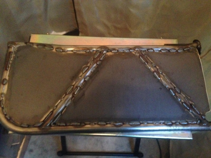

    Practice 1. im pretty much set on just doing it after this first take. the 2:1 ratio seems to work great, not eating through the 16g AND its not warping nearly as much as I thought.
    I ran that long center bead to get the metal to warp, and it took about a 3.5" section continuous to get it to warp just slightly.
    The two on the left are the size im mainly gonna run...all over the doors. more like stitch welding, but connecting them in the end.
    and for penetration, shouldnt be an issue.

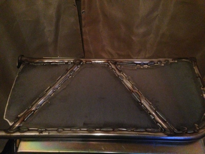

    you can see again, that long run in the middle right side was bout to eat through, but none of my smaller 1.5"ish lines did any damage.

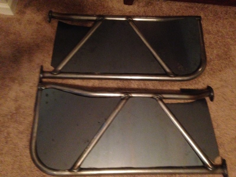

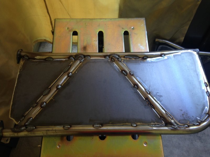

    this shit takes WAY too long, skipping around so u dont burn thru.....it better be worth it haha

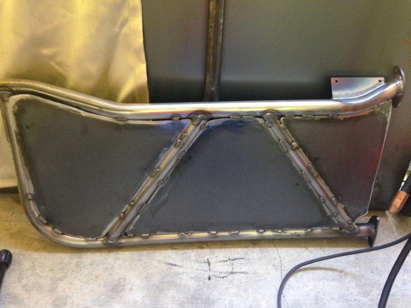

    same pic angles, sorry for the dump-age, but here is where I sit as of tonight. gotta get more gas tomorrow to finish, and I think itll def get done tomorrow.
    the only pieces that warped a little were the 'front' pieces, which makes sense, since they are only welded on 2ish sides. I didnt think about that until after I saw it and wondered why it warped but not the other two panels. lesson learned through experience, ill take it (earned it haha). other than that, its going as planned.
