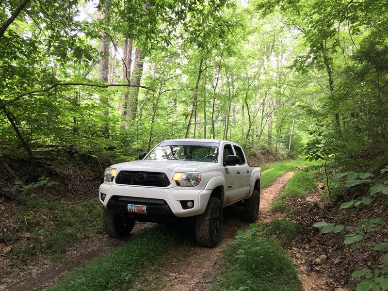

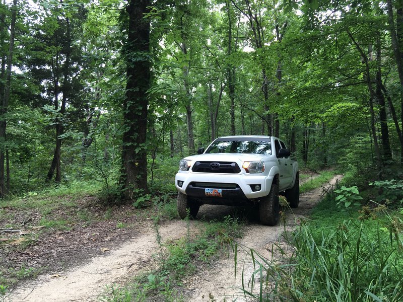

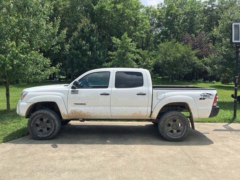

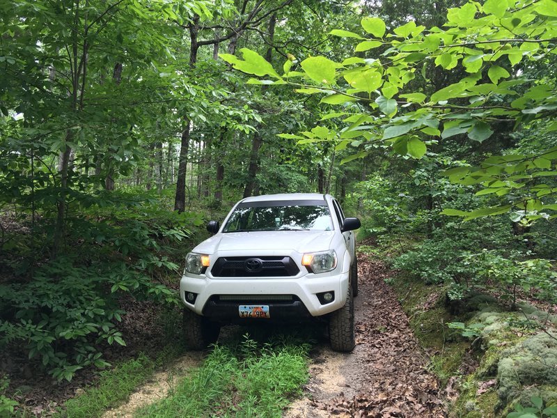

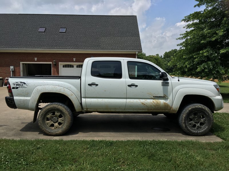

    image.jpg image.jpg image.jpg image.jpg image.jpg Found a pretty cool trail out behind the maintenance and hunters checking station. Got a lil bit of mud on the truck. :cool: Next time I need to remember to take the hitch off lol. (Really I need 33"s with a high clearance going through all the creeks I went through lol):rofl:

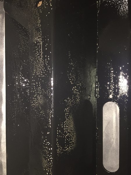

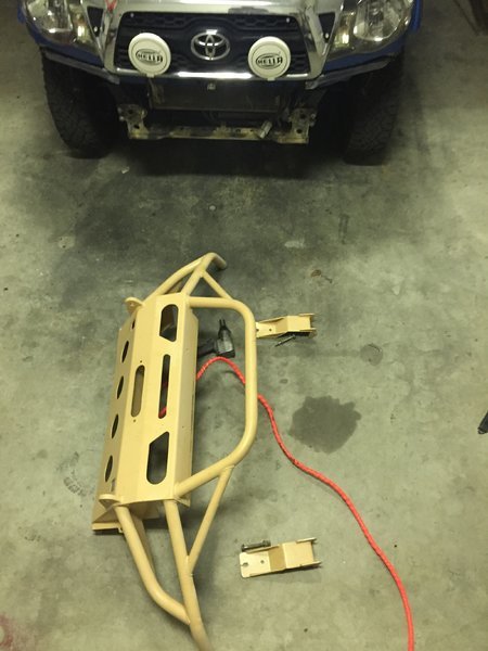

    Ok so took the bumper off today to put some paint on it since I get to have my wife's car also for three weeks. I roughed up the paint and started on the back side of the bumper but when I was laying down a coat it would do o splotch pattern. I used 220 grit to roughy it up and then wiped down using just gloss Rustolium paint in a can. I don't know what the coating on it was as Levi put that on. But anybody got any ideas. Picture for reference.

    It's a duraplate coating, it's past its recoatng window so a light sanding over the whole thing wouldn't hurt. But my guess is there is some sort of contamination on the surface that's making the paint do that. I'd sand it down a little rougher than the rest of the bumper then wipe it down with mineral spirits or some kind of paint thinner. Let that dry for a minute then respray it.
