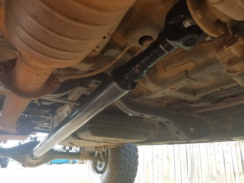

    Looky what I got today.....

    Yeah I fucked it up good at AOP. I just now got it replaces. Haha

    Did you have a carrier bearing before?

    What's up with you gheys going with 1 piece shafts?

    Cheaper and don't have to worry about carrier bearings

    Yeah. I had the stock driveshaft.
    Yeah I thought the last one was big. I was way wrong!!
    I'm not sure what the stock one is but it's 2" x something. Mine is 3" x .95 wall, so its much stronger, does away with the carrier bearing, does away with a u joint, provides more travel and makes somewhat of a anti wrap bar by eliminating that flex point. I also paid $183. Boom!!! I drove it last night for about 20 mins and I can really tell how bad my stock one was. The combination of it being unbalanced and the carrier bearing wearing out made the truck really shake a lot and the driveline move around a lot with the throttle. Feels so much better now. But it made my crappy alignment stand out more. Haha gotta fix that next
