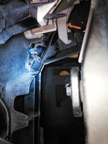

    thanks for the replies.
    So I'm not going to worry about adjusting the fronts down or shimming the back up. First thought actually was to take some thick barstock and basically make myself a spacer lift in the back. I'll give it a few weeks and see how it settles. In the meantime, guess I should adjust my headlight aim down a bit. maybe :devil:
    Guess they changed the grills at some point.
    Mine has 2 screws and 2 pins up top. The bottom just had tabs that stuck out and went into slots on the OEM bumper cover. The only push pins down there were for holding the bumper cover.
    I had an epiphany though and the grill is all good now. Made myself a pair of brackets. My grill has a bunch of torx screws that hold the surround trim piece to the main grill piece. One of those screws is right in front of a hole where one of those push pins was holding the bumper cover. I just bent up some metal banding to use in one of those screws and put a pin in the original location at each side along the bottom of the grill.

    My grill is mounted the same way (2 screws and 2 pop clips in the top then clips in the bottom) and I've been told to use zip ties once I get my plate front bumper as well but if your trick is pretty quick I might just have to do this instead. Would you be able to take pics of what you did?

    pics looking down. I did this at both sides. The "banding" metal is cheap and can bend by hand. Had to drill out one of the existing holes in the banding to fit the oem plastic push pin through. The blue is just some vinyl tape I put on to cover the sharp edges.
