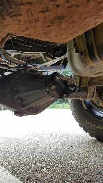

    On a lighter note, my driveshaft exploded at 70 mph today. I found it 30' off the highway through a fence in a horse field. Either the slip yoke broke or the flange on the diff side broke which obviously caused the other one to break. Good part is there wasn't a car insight either direction, I haven't found anything but small cuts on the pass drum and wheel, hell i didnt even run it over, and the driveshaft itself held up VERY well with just scratches from where it initially dug in the ground. Bad part is I need a fucking driveshaft!!

    My guess. Circlip(s) came out on transfer case end, end cap(s) walked off u-joint, drive shaft failed and broke rear pinion flange.

    For that u joint to still be there, you may be right
