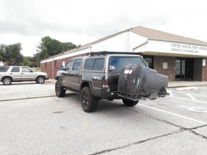

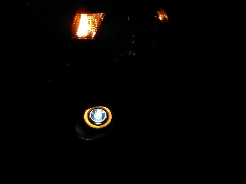

    Just put these on my build page but I'll put them here too just cuz...
    Cargo tray successful in its first use and fog lights finally arrived.
    beertimecontinuum and Dave41079 like this.
