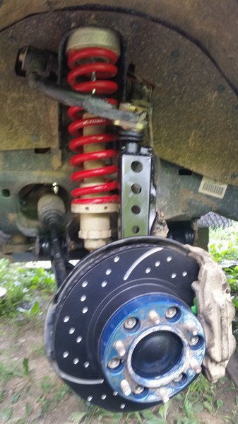

    What setting are you're coils set at?

    0". That gave 2-1/2" lift. I went back and put 1/2" poly top plate spacers on, and now have 3-1/16" above stock ride height. Got 2.8 right side and 2.9 left side caster with stock UCA's, no rubbing, and a decent ride. I do NOT like preloading coils to get lift. I used to work for Honda years ago in their HRC division. (raced dirt bikes) I was a suspension tech for a while. I was taught to NEVER preload coils without changing rebound dampening to accommodate, or you would create a jackhammer effect. Old habits die hard.

    That's what I thought but wanted to double check since all I know is 1st gen.
    Yeah preloading just makes the ride worse, when I get my Kings I'm going to try and get as little pre-load as possible.
