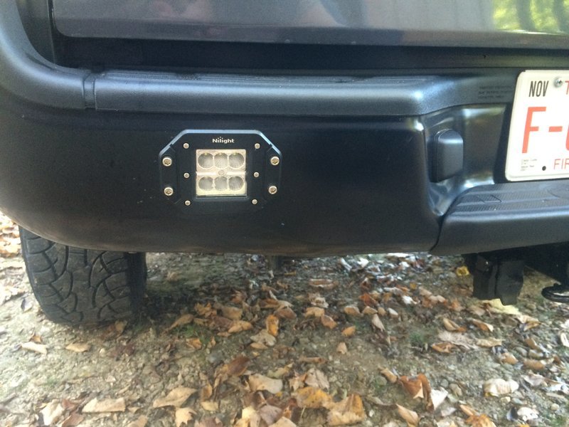

    I am jealous that you had the balls to hack up your rear bumper. I apparently cannot do this haha. But it looks great!

    Cut & broke off stuff. Prolific ziptie and tape usage.
    Do it.
    You can go through 8 sets of cheaps and still spend less $$ than 1 set of big name lights would cost.
