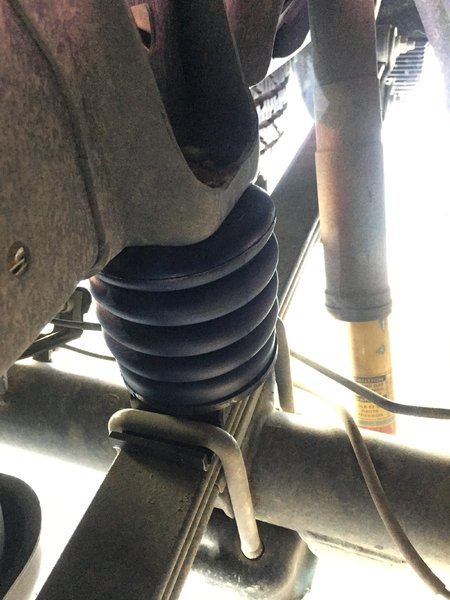

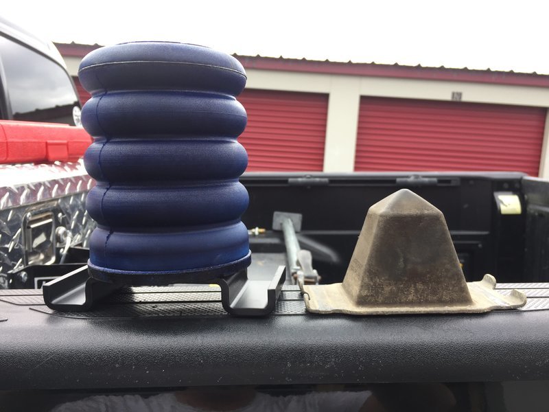

    I added them on my truck, they replace the factory bumpstop. Not sure with your lift if they'll work but they lifted my truck about an inch at the rear axle.

    So, these essentially stiffen the rear and don't allow any sag? How do they perform off road with rear articulation?

    They are stiff and can limit your up travel which can make the opposite wide of the axle want to come off the ground easier...but you can unscrew them by hand if you really wanted to (only for offroading purposes, and you'd have to take it easy rolling with absolutely no bump stop)

    Definitely something for me to consider, especially since adding the shell, plus I keep it stocked full of shit all of the time, so there's always extra weight in there.
    Do they work similar to airbags? Are they adjustable?
    AR15xAR10[QUOTED] likes this.

    Not adjustable. They are progressive. The more weight you put on, the stiffer they get.
    I had a cap on for a couple years. I highly recommend some sort of help back there. Having that cap on there flattened and ruined my OEM leaf springs in about 35k. Then i continued to drive it until 50K when i lifted it. At that point, both rear shocks were blown.
    I didn't want air bags because i eventually will lift higher.
    These are cheaper (mine were $171 shipped from autoplicity)
    Its a 5 minute install, Airbag installs are way more complicated.
    I did a 210 mile road trip with a 500lb atv in the bed right after i got these and it was a world of difference. No more slamming into the pointy OEM bump stops every time you hit a bridge expansion joint

    So far I'm pretty happy with them. I think the ride is a bit better, and when I added the steal rear bumper it only dropped the back 1/16". They have 1000lb xtra load rating. There is also a model for the Tundra that's got a 1500lb rating if you tend to haul alot of heavy stuff. When I put the front coil supports on to compensate for the front bumper/winch it greatly improved the ride/handling. If you email the factory with your measurements, they can probably tell you what model should fit.
