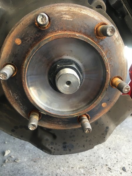

    Doing my wheel bearing and I don't have a power/ impact drill....
    Is there any way in hell to get the 36mm bolt off holding the hub without one?
    It will just spin and spin when trying to use a bar...
    I guess the CV axle nut, is what I can't get off, because the diff can still move? Is that correct

    Could probably put it in 4wd (if you can get it to engage without the truck rolling) and essentially use the weight of the truck on the rear wheels to hold it

    Or put the wheel back on and lower it back on the ground while you break the torque.

    This guy has the right solution. This is exactly what you do.

    Knoxville. And you guys are bunch of geniuses. Thanks for the help. Got both wheelbearings replaced, good to go
