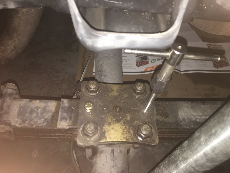

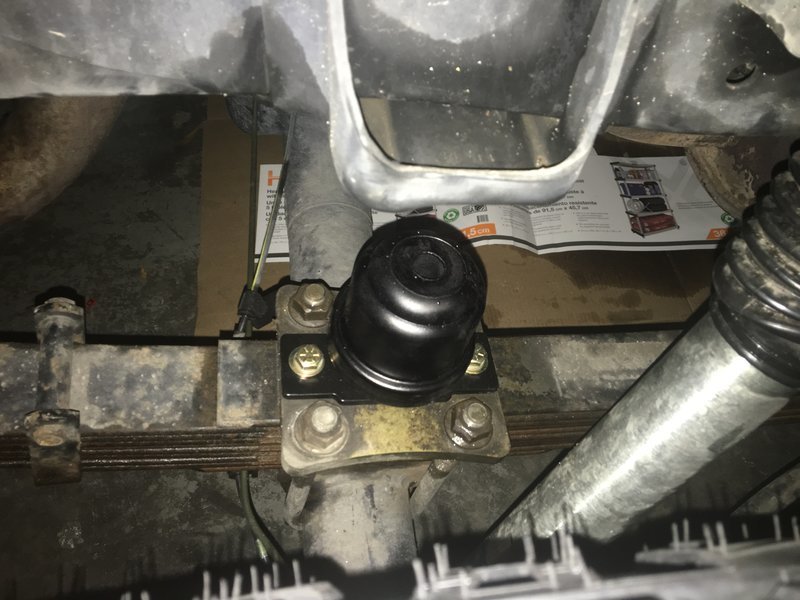

    Tapping the holes on the flip plates while still on the truck was a bitch. But they are on there. Lol

    Bruh....! I took mine off to drill and tap the holes. I'd think it would be easier than doing them in place. Took about 45 minutes to do both.

    Mine were already drilled. It only took me about 30min

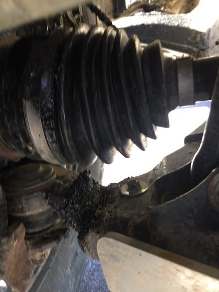

    Am I going to destroy the axel if I drive on it till the weekend? i.e. Should I get a rental?

    No you will be fine, it will just throw grease all over the inner fender. Just remember to inspect the axle inners when it's all cleaned up.

    curious myself in case this ever happens to me...
    Can he just add a few squeezes of grease and wrap some ducktape or something around to hold it in there til he has time to work on it?

    I have been driving on a ripped boot for about 2 weeks now. Even if you add grease it will just throw it out and make a terrible mess in the wheel well. Best plan is to avoid anything like sand or dirt until you can fix it. (sand and dirt will remove surface area on the metal in the birfield after a extended period time of no grease and fatigue it making it easier to break)
