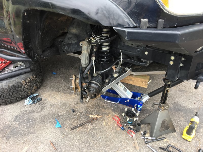

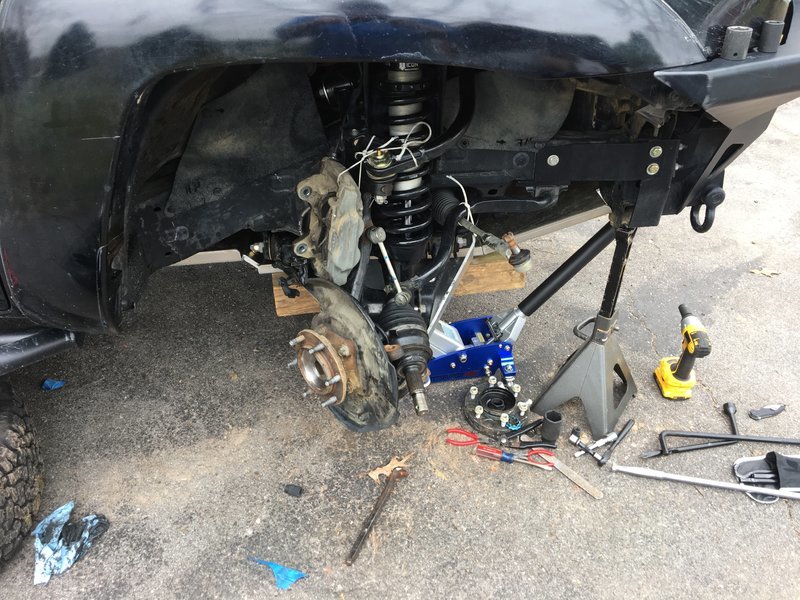

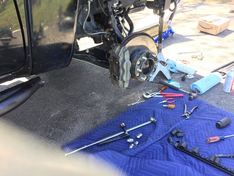

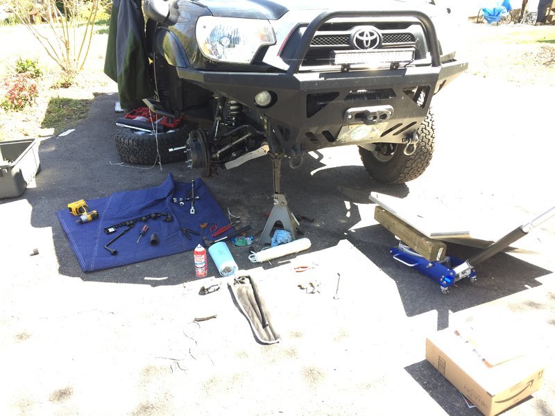

    Twas my Saturday. With the @Mr.Bl0nde aka John's help I swapped out the passenger side axle for an Amazon special. That'll get me by till I can fix the old one, or find a used OEM replacement. I had intended just to repair the torn boot, but as things sometimes don't go as planned. I ended up have to do a complete swap after 1) I had trouble getting the hub separated from the axle, I messed up the threads a bit. 2) I had a miss understanding of how the axle is assembled, Gid was kind enough to straighten my thinking out after having a chuckle at the "C" teams expense....o_O Thanks to you both:cheers:, I'm no longer throwing grease all over the place and I get to drive my truck to work on Monday! :woot:

    "C" team huh? You get a promotion? ;) For me the hardest part is getting the axle out of the diff. A neat trick for popping the stub loose from the hub is to place the round side of a ball peen hammer in the center of the depression on the end of the stub shaft, then hit the flat side with a dead blow. You don't mess up threads that way. I've messed up a lot of threads by spinning the castle nut back on and hitting it, but they can usually be fixed with a die run across them, or a little file work.
