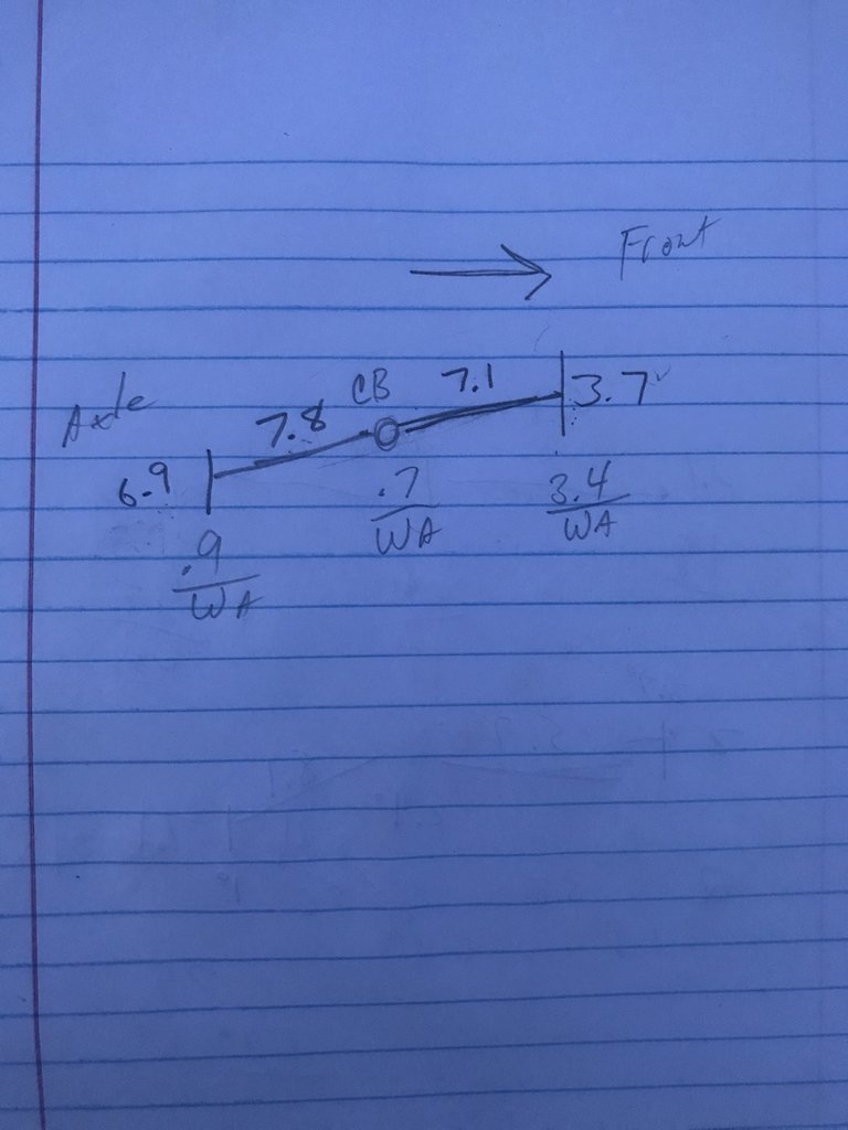

    So to eliminate drive line vibrations. What should I do? My current measurements are IMG_7334.jpg

    Dave suggested removing the rear driveshaft once upon a time. I like that idea.

    3° shim at the axle to reduce the angle back there.
    That will only tell you if that's where the vibration is. I guess it would fix it if you wanted a front wheel drive truck.

    He already has a 3* shim

    depends.
    From the factory, we don't meet Dana/Spicer recommendations.
    Try raising center to reduce front angle but keep front shaft within 1 degree of axle. See how that does.

    What direction is it pointed? Perhaps removing the shim would get him where he needs to be. It appears he's 3 degrees off...
